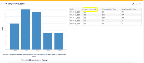

-We have created a dashboard with the TTR and are wondering why there are "Unresolved Issues" in the first column, there should only be Resolved Tickets in there, right?

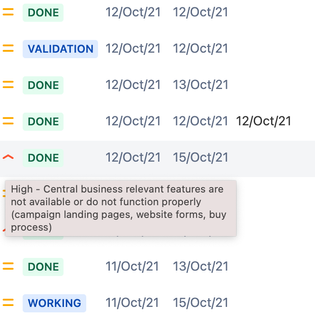

-And in the list of tickets there are some that still have the status "Validation" or "Working"

But it's still not clear  why does the first column of the diagram say "Unresolved tickets"? In the list are tickets which are Resolved.

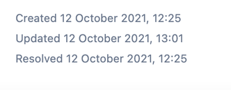

-Resolved date is the same as Created date - why is it so?

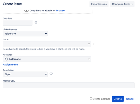

It looks like there are some misconfigurations in your environment.  For example, beside validation, you have a checkmark with open. This means that the ticket was resolved in jira terms.
You may have a workflow postfunction or automation that sets the created ticket with "Open" resolution. Which is being misused. Which makes sense with the dates and history you shared.

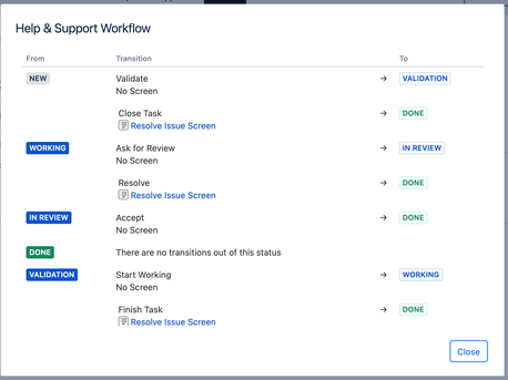

Can you give me some feedback here? Unfortunately, I can't find a place in the settings where we can adjust the resolution field accordingly. Our workflow status looks like this:

When we create a ticket, the field "Resolution: Open" is automatically set. Only after we move the ticket into Validation, the field disappears.

Fabian Lim
November 30, 2021
You have to get to the postfunction of your workflow:
https://support.atlassian.com/jira-cloud-administration/docs/configure-advanced-issue-workflows/
You have to be a system admin to change this. Maybe that's why you can't get into the settings.
