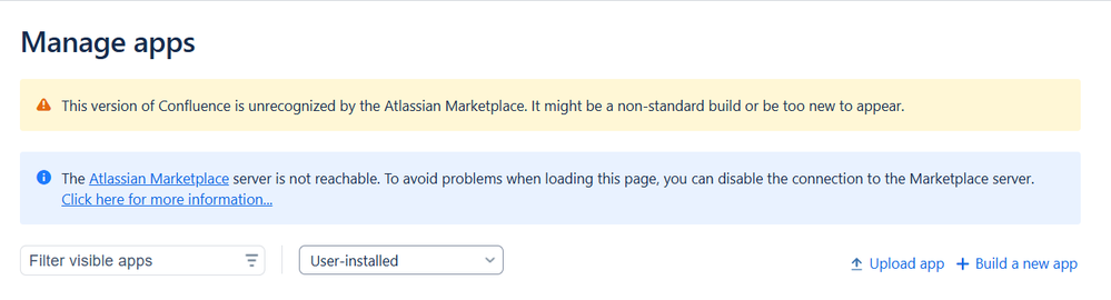

Hi Community Folks,
Recently I refreshed the data in my Confluence Data Center staging instance from Production backup (Version 9.2.19).
Instance is up and running successfully but the instance is not able to communicate with Atlassian marketplace even though from the server all the required URL's are reachable.
3 answers
Mayuresh Kamble
May 22, 2026
Hi @Trudy Claspill  and @Enric Font ,
Thank you for providing the solutions. The issue was with setenv.sh file, there was an https proxy port argument which I removed and instance is able to connect to marketplace now!
Regards,
Mayuresh
