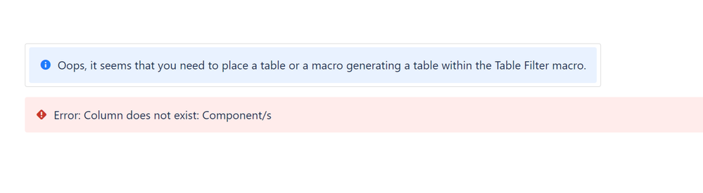

The table we have created on sevewral confluence pages don't appear anymore and this error appears on the confluence page (see joint image).  Is this a problem with the table filter like indicated por the table transformer? What am Isuppose to change?
Thank you for your help,

Hi @Raymond de Ribains ,
The error means just what it means: in the Table Transformer macro you refer to the "Component/s" column but there is no such column in the source table. So, the SQL query breaks.
Judging by the column name, your source table is generated by the Jira Issues macro - check if this column is present in the source table and that you use the correct name.
