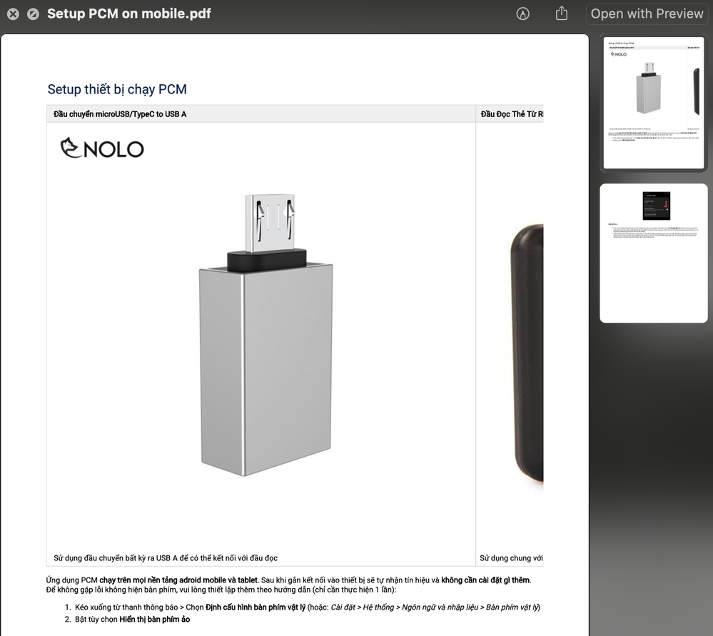

Dear Confluence Team,
After I finished writing a series of documents on Confluence, I wanted to export it to PDF format for easy storage and sending to my partner. However, the output format was relatively disappointing to me. I don't really know how to fix it so that it doesn't get any error like the image below because everything looks perfect on the web. This error is in PDF and Word formats.
After finding out I have referred to the topic below.
https://support.atlassian.com/confluence-cloud/docs/customize-exports-to-pdf/
However, it still doesn't address my need to force all the content to be on the page. I have tried to add the code below to re-styling the content as I output it.

1. PDF view

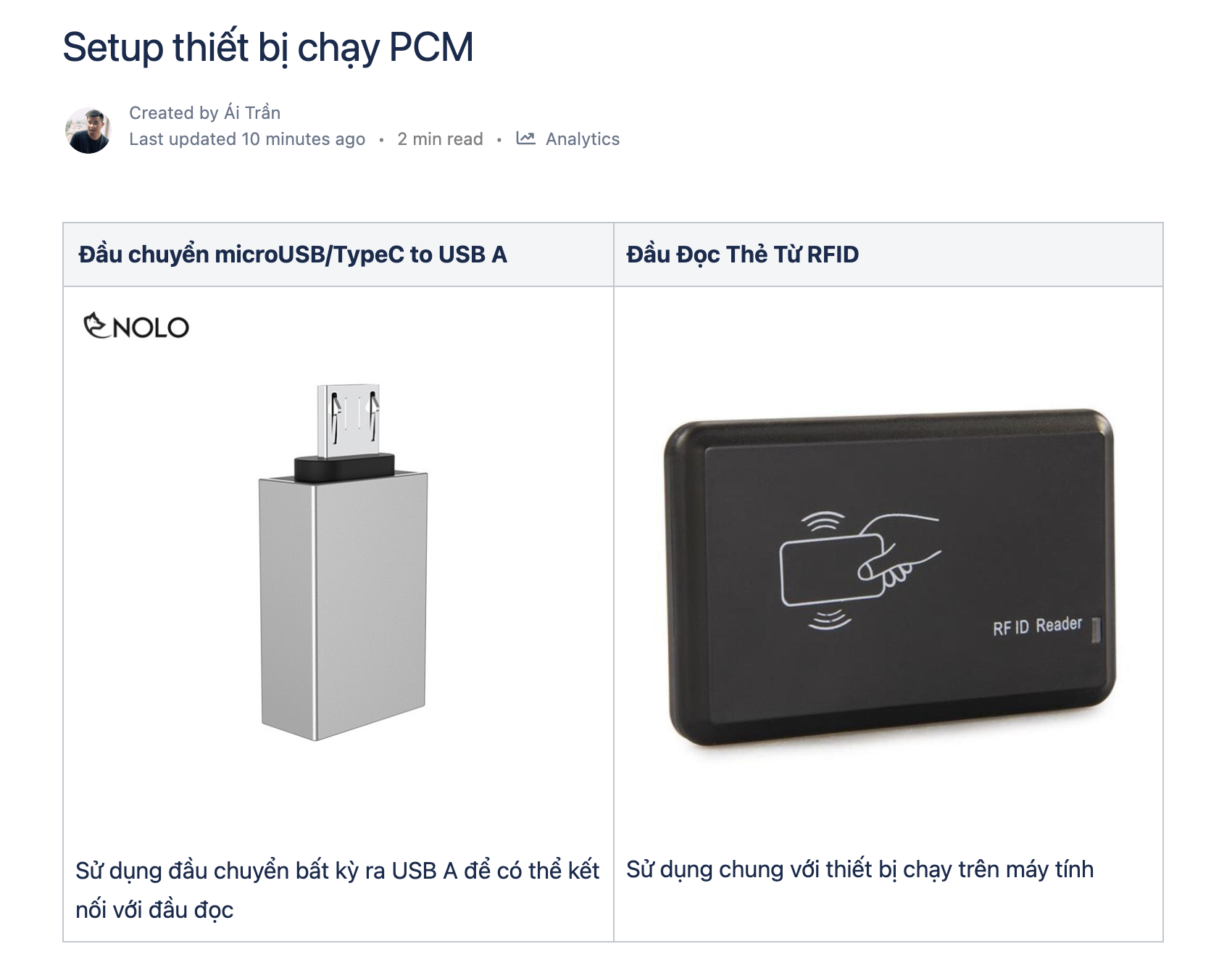

I believe you are referring to the cut picture of the RFID reader whilst you expect that the column is fitting on one page, right?
PDF exports seems having some open Suggestion and Bugs. One that I found is:
https://jira.atlassian.com/browse/CONFCLOUD-66173
Please make sure you vote for it ("this affects my team") as well to watch it ("Start watching this issue") to be informed about the progress.
The workarounds listed there did not work for you, am I right?
Apart from if they work or not - CSS stylesheets putting into space settings is not everyone's cup of tea - so a sustainable fix would be better.
Please vote for the Bug mentioned above in any case - probably somebody here can come up with a solution you can apply meanwhile.
