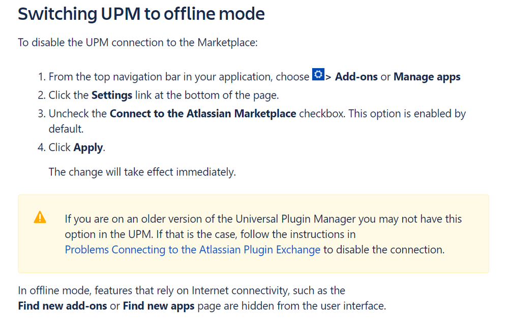

I found an article about disabling the connectivity to the marketplace, and  I have disabled it following the instructions.
I will have a look tomorrow whether will it return to the normal state.

After I disabled the connectivity to the marketplace, the website returned to a normal state.
Thanks for your advice.
