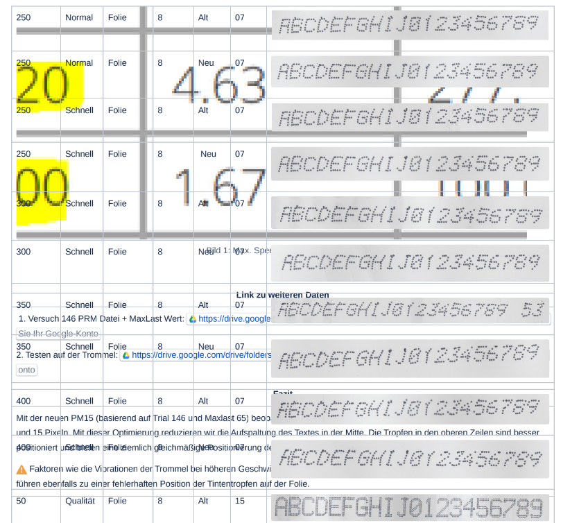

I have a huge report filled with Texts, various Images and Videos, when exported as Pdf, the Texts, the images and Videos are sometimes wrong format and some are mixed with each other.
Do you have any recommendations with which format I should load the Images or Videos with?
Or do I need to make any changes in settings during exporting?

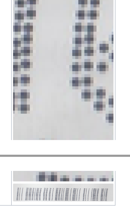

Sample Image is attached below. Hope this helps in understanding the problem. Thank you for the suggestions!

@Chethan Gowda Yashodara by any chance are you hitting this bug CONFCLOUD-72746 ? is this happening to all of your attachments?
August 25, 2023
@Sayed Bares [ServiceRocket]yes my problem is a part of what is described in that Ticket. The 2nd Picture in my above query shows my problem related to the ticket. The images loaded are all pretty much of similar sizes. Most of them maintain their original size but a few are enlarged.
