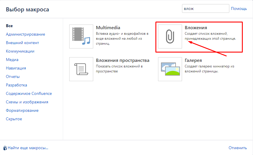

The attachment macros
551550
December 26, 2018

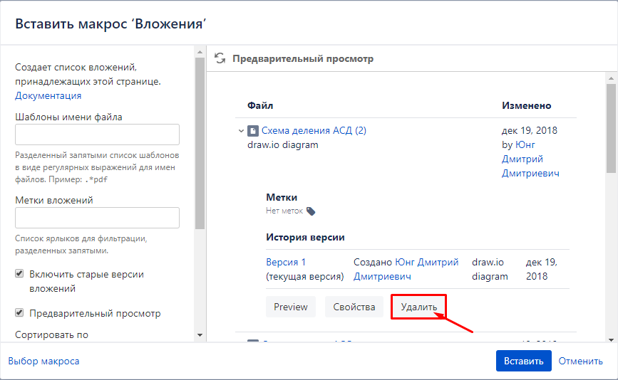

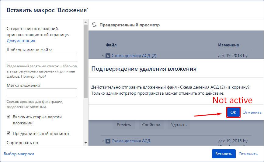

Hello! We need help. Our attachment macros does not allow deleting page objects. When we try to delete an object, we see a dialog box with a suggestion to delete the object. However, the "OK" button is not active. Administrative rights configured correctly.

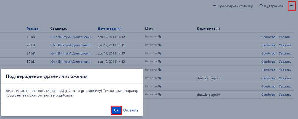

5) A user (administrator) cannot delete attachments from the menu
6) When the user clicks the "OK" button, the action is not performed, the dialog box does not close
