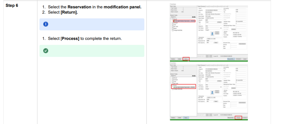

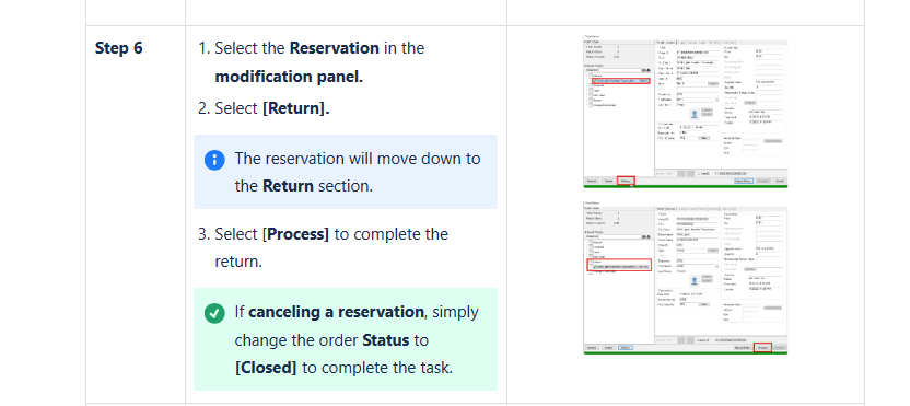

@Dan Breyen the bug you tagged may in fact be my problem. For clarity and perspective this is what the same section looks like within confluence:
Notice how the text does not display within the info boxes on the PDF screenshot attached previously. It might have something to do with the emojis or perhaps being inside a table...
I've tried Chrome and Edge browser export. I've tried exporting using print function within the browser. I've tried word export (while text was visible the boxes obviously are not clear. It is happening for all page exports, noticed it for the first time a few days ago, thought it was the page.
Exactly the same issue here as well. It has nothing to do with the panels being inside a table or not, it happens regardless where these panels appear on the page. Happens for all users and also applies for all Confluence pages. This is a recent issue that has been introduced unfortunately. Should be easy to replicate and hopefully a fix is not too far away?

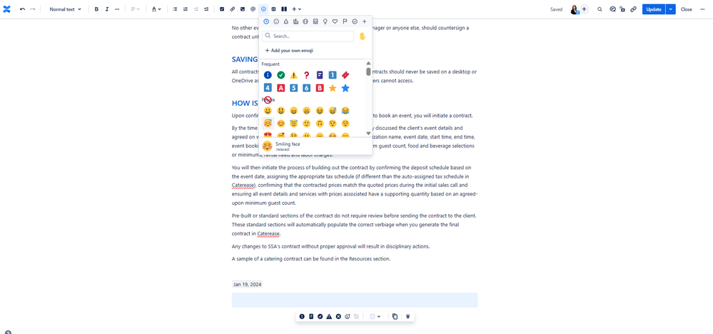

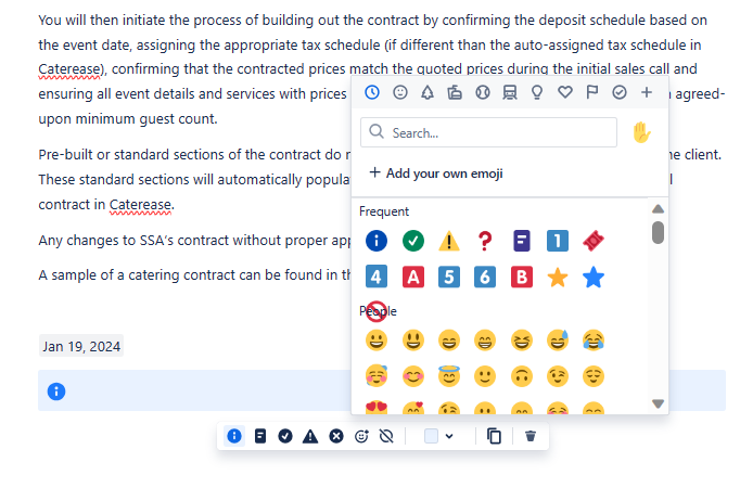

Do not use emojis (warning, info, etc) from the selection option within the box itself (see below).
Example:
Instead, delete the Emoji populated, then go to the top and add an Emoji (Warning, Info, Error, Success, etc.) and place it in-line with text (see example below).
The image looks a bit different but is the same effect regardless.
