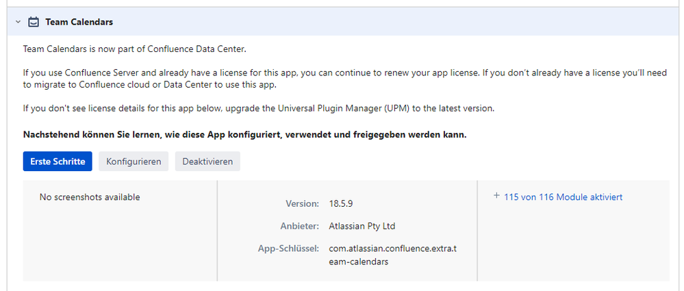

Having clicked on that message, i'll see:
If you use Confluence Server and already have a license for this app, you can continue to renew your app license. If you don’t already have a license you’ll need to migrate to Confluence cloud or Data Center to use this app.
If you don't see license details for this app below, upgrade the Universal Plugin Manager (UPM) to the latest version.
As i told before, i've already upgrade to Data Center, and the Universal Plugin Manager has the most current version number.
So, what shall i do to get rid of this message? (The app itself seems to work without problems. But the message is boring)

I don't have access to a Data Center instance to test with at the moment.  However, just thinking, Is there a license string for this in the UPM?  If so, remove it. It could be getting confused as no string is expected..

Thanks for your response. I just had look inside the UPM, but there isn't any license string. All i see is the following:
And as i said above: The UPM seems to run in the most current version.
