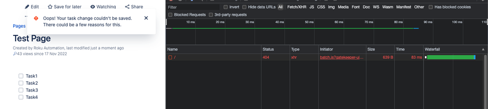

Task list macro created through REST API call throws unknown exception when user tries to check the task. User needs to click edit page button and click update button as a workaround to fix the issue.
Are you referencing the checkbox tasks?
What is the error message? Can you add an attachment and the error code return?

Hi Florian,

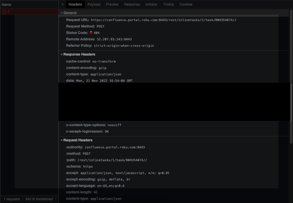

Yes, I see issues with checkbox tasks. The API call returns a HTTP 404 error when I click on one of the checkbox.

You should blur cookie information for security purpose.
Is the Confluence base url right ? Do you reach to 8443 or do you have Confluence behind a proxy ?

Thanks, I have updated the image. Yes, the confluence server is behind a proxy. Does that cause any issues when publishing content through APIs?
Found the fix. I was missing task-id for each task in the list. Thanks for the help, @Florian Bonniec
