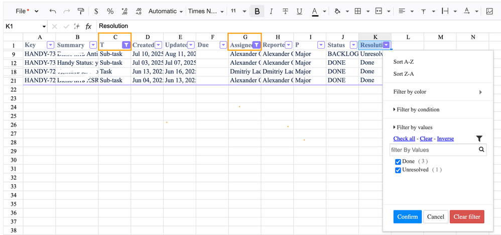

Seems that we don't get the issue: the Spreadsheet from Table macro allows you to set filters to any number of columns as you do it in Excel.
For example, here is an outcome of our Jira Issues macro in the Spreadsheet from Table macro:
The two filters are already set (for the Type column and the Assignee column - active filters are shown in violet) and we also can add another filter as well (for example, for the Resolved column).
If it goes differently for you, let's move to our support portal. It's confidential, you'll be able to share your screenshots and other details freely for further investigation.
