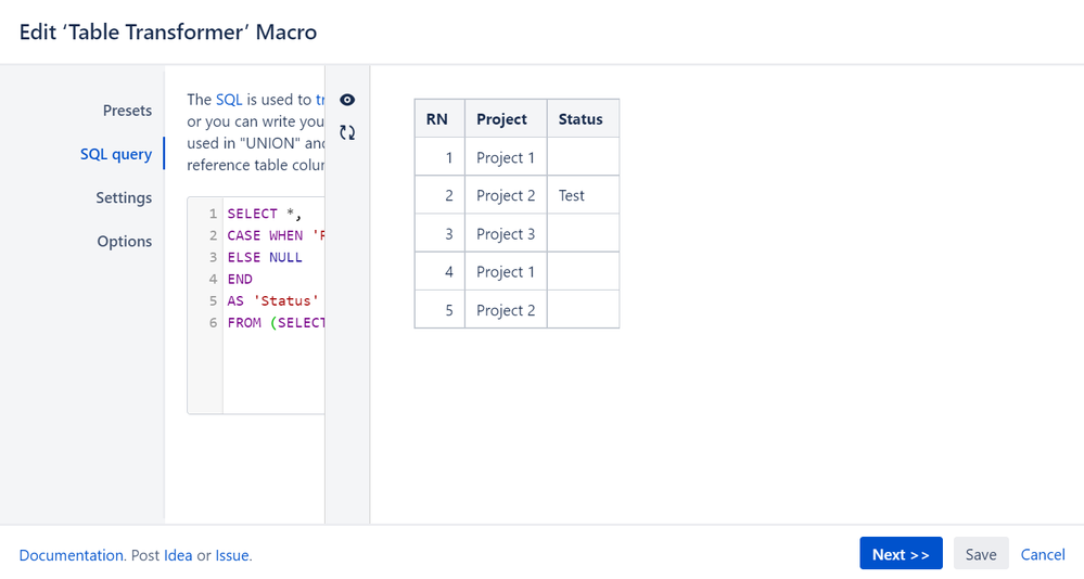

Hi @Karthika_Natarajan ,
You may try to nest the second query in the FROM destination of the first query. Here is an example for you:
SELECT *,
CASE WHEN 'RN' = 2 THEN "Test"
ELSE NULL
END
AS 'Status'
FROM (SELECT rownum() as 'RN', T1.'Project' FROM T1)
Hope this may help your case.

Try to remove the T1."XXX" reference from the first part of your query:
SELECT
CASE
WHEN T1.'RN' IN (1,5,9)
THEN "Test"
WHEN T1.'RN' IN (2,6,10)
THEN "Dev"...
SELECT
CASE
WHEN 'RN' IN (1,5,9)
THEN "Test"
WHEN 'RN' IN (2,6,10)
THEN "Dev"...
The query tries to look for the "RN" column in the first table but there is no this column at this stage, we add it in the end of the query.
My original example looks like that:
SELECT *,
ELSE NULL
END
AS 'Status'
