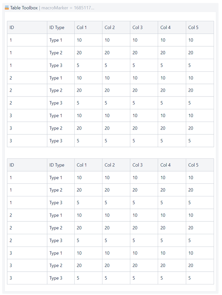

Seems that there is smth wrong with the example of your table: if every ID has three types (and your last sentence points at that), then the existing 'ID' column should be named 'ID Type' or smth and there should be another separate column for the 'ID' itself.
Please see the screenshot below:
Fri 7-1.pngHere when you filter by the 'ID', you'll get three rows (Type 1, Type 2, Type 3 for each ID). Let us call this variant as option 1

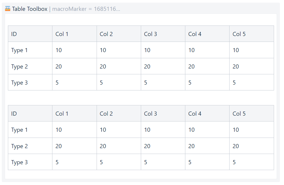

And here is the option 2: with a table from your screenshot.
Here when you filter by the 'ID', you'll get one row every time: each ID is just some type with a number.

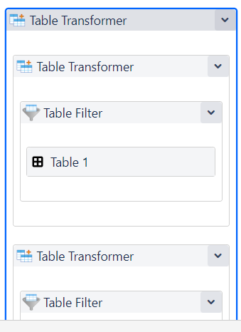

Then go to the Table Toolbox macro and create the following macro sequence inside its shell:
Each table is wrapped in the Table Filter and then in the Table Transformer macro (let's call them internal). And then everything is wrapped in another Table Transformer macro (external).

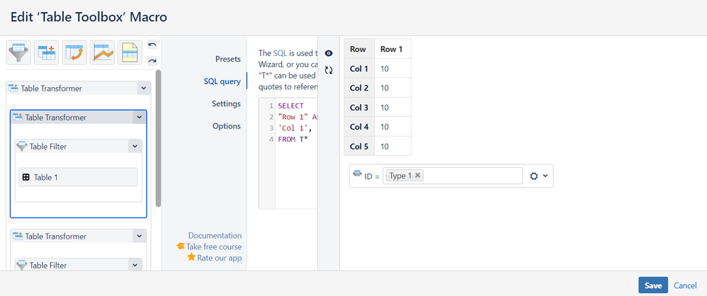

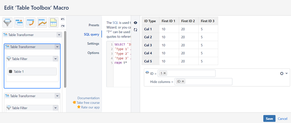

Option 1

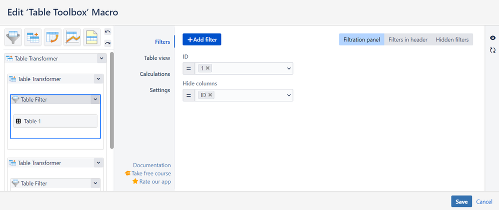

Go to the Table Filter macro and set the dropdown filter for the 'ID' column and then choose to hide the 'ID' column:
Do it for both Table Filter macros.
Then go to the first internal Table Transformer macro and use the following SQL query:
SELECT 'ID Type',
'Type 1' AS 'First ID 1',
'Type 2' AS 'First ID 2',
'Type 3' AS 'First ID 3'
FROM T*
Go to the Settings tab and check the "Transpose source tables" option.

Option 2

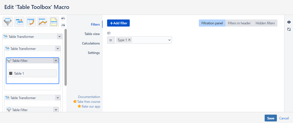

Go to the Table Filter macro and set the dropdown filter for the 'ID' column:

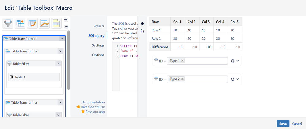

Then go to the external Table Transformer macro and use the following SQL query:
SELECT T1.'Row', 'Row 1', 'Row 2',
'Row 1' - 'Row 2' AS 'Difference'
FROM T1 OUTER JOIN T2 ON T1.'Row' = T2.'Row'
Go to the Settings tab and check the "Transpose result table" option.
Here is your result. You may choose not to show the 'Row 1' and 'Row 1' data as well:

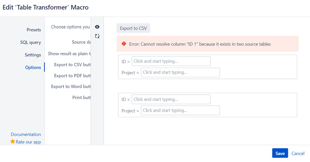

Back to my case with option 2, I have 1 remaining question is that after using above suggestions, it will show an error message of the external table transformer at the beginning: "Cannot resolve column "Row 1"  ("ID 1") because it  exists in two sources tables" as below.
It actually has no impact to the function because once there are inputs in the filter, this error disappear. But I'm thinking whether can set a rule to replace the error message to reminder, such as "Please select the ID and project..."?

Stiltsoft support
Atlassian Partner
May 28, 2023
Hi @Alice Liu ,
The message you see is an error belonging to the external Table Transformer macro when it tries to process the unfiltered data. If you clear the filtering panels or choose more than one ID for each field and go to the preview of the internal Table Transformer macros, you'll see that you indeed get "wrong" tables - all the columns will be named 'Row 1' and 'Row 2' respectively. As the Table Transformer macro treats the source tables as mini databases, it is confusing for the macro, hence the error.
As usual, we have an option to remove such system messages (for example, if the query returns no entries or smth): you may use another Table Transformer macro on top with the default SQL query "SELECT * FROM T*", then go to the Options tab -> Source data and choose to Hide all content.
But this option won't work for your case: not only the error message will be hidden, but the filtering panels as well (and you need to filter your tables on the fly).
Maybe it will be more clear for your users to use an Info/Warning macro before the Table Toolbox macro indicating the correct behavior: to choose one item per filtering panel.

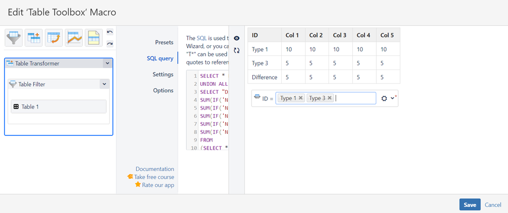

I've also consulted with our developers regarding your case: they came up with a kind of a workaround where you were not supposed to get any errors.
Wrap your table (one copy, not two) inside the Table Filter macro and then inside the Table Transformer macro.
Set the dropdown filter for the 'ID' column as we have done before.
Then go to the Table Transformer macro and use the following SQL query:
SELECT * FROM T1 LIMIT 3
UNION ALL CORRESPONDING
SELECT "Difference" as 'ID',
SUM(IF('N' = 1, 'Col 1', 'Col 1' * -1)) AS 'Col 1',
SUM(IF('N' = 1, 'Col 2', 'Col 2' * -1)) AS 'Col 2',
SUM(IF('N' = 1, 'Col 3', 'Col 3' * -1)) AS 'Col 3',
SUM(IF('N' = 1, 'Col 4', 'Col 4' * -1)) AS 'Col 4',
SUM(IF('N' = 1, 'Col 5', 'Col 5' * -1)) AS 'Col 5'
FROM
(SELECT *, ROWNUM() as 'N' FROM T1)
The "Transpose source tables" and "Transpose result table" options should be unchecked, we don't need them here.
Now when your users select one ID, they will get this specific row and the Difference row that will match this ID row.
If your users select two IDs, they will get two rows of data and the Difference row. The only peculiarity is that there is no any difference in the order: 10 and 20 will be -10 as well as 20 and 10 will be -10.
If your users select 3 and more IDs, then they will be shown the first three rows of your table without any calculations.
You may check the behavior yourself and see what suits you more. Seems that this is all we can do here.)
