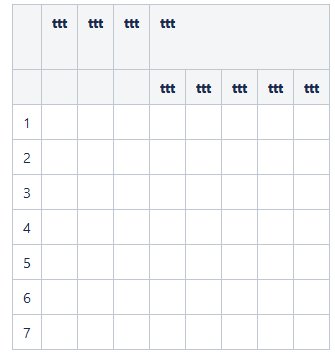

we do have an annoying issue with tables in Confluence since upgrading to 7.10.2.
In the edit mode of the page, the table looks like this:

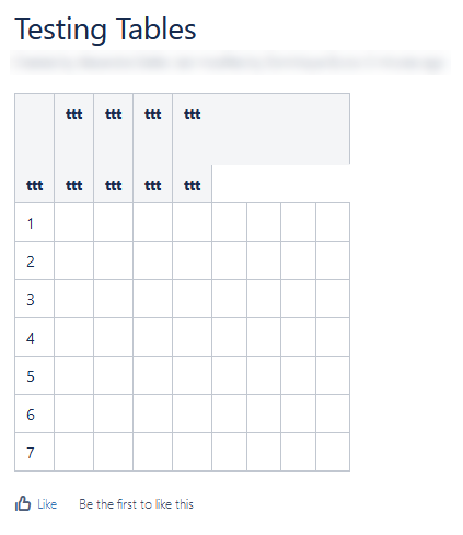

Once the page is saved, it looks like this:
We tried different browsers (Firefox, Chrome), deactivated nearly all plugins we have and cleared the browser Cache, restarted PCs and so on.
Does anyone have an idea?

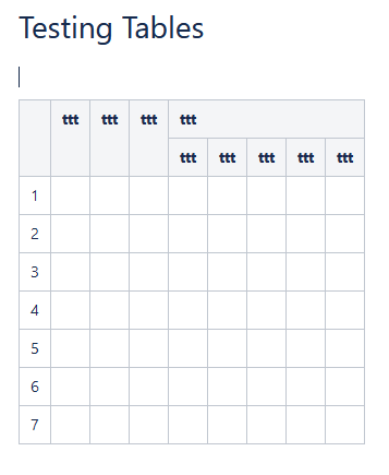

This happens if one or all cells in the top left corner are merged vertically. If I unmerge them, it looks like this and works as expected:
Cheers,
Dominique
