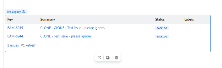

I used to be able to set the maximum number of issues for Display in a table, and beneath the table on the Confluence page, it would display "2 out of 12", or whatever. It would indicate that there were more issues being returned by the filter than just those displayed.  That is no longer the case. All of a sudden, it just says "2 issues".

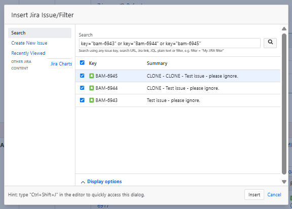

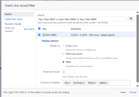

Hi. Thank you for your response. I don't think I'm using the "work items macro" you mentioned. I've attached 3 screenshots. I set up a sample table to show what's happening. I created 3 sample cards and used a very simple filter to display all three items (key=xxx or key=xxx, etc.). Then I expanded the "Display" link and specified that I only wanted to see 2 of the 3 items. That is exactly what is being displayed, but the problem is where it says "2 issues" next to "Refresh" at the bottom of the table.  Previously, it would have displayed "2 issues out of 3".  I found it helpful when I wanted to know how many issues were in a table even if theyweren't being displayed. I am the QA Lead of my group, and I sometimes choose to filter out issues that have a certain status, but I still want to know that they exist - I'm just choosing to not display them. Does that make sense?table.pngfilter.pngdisplay.png

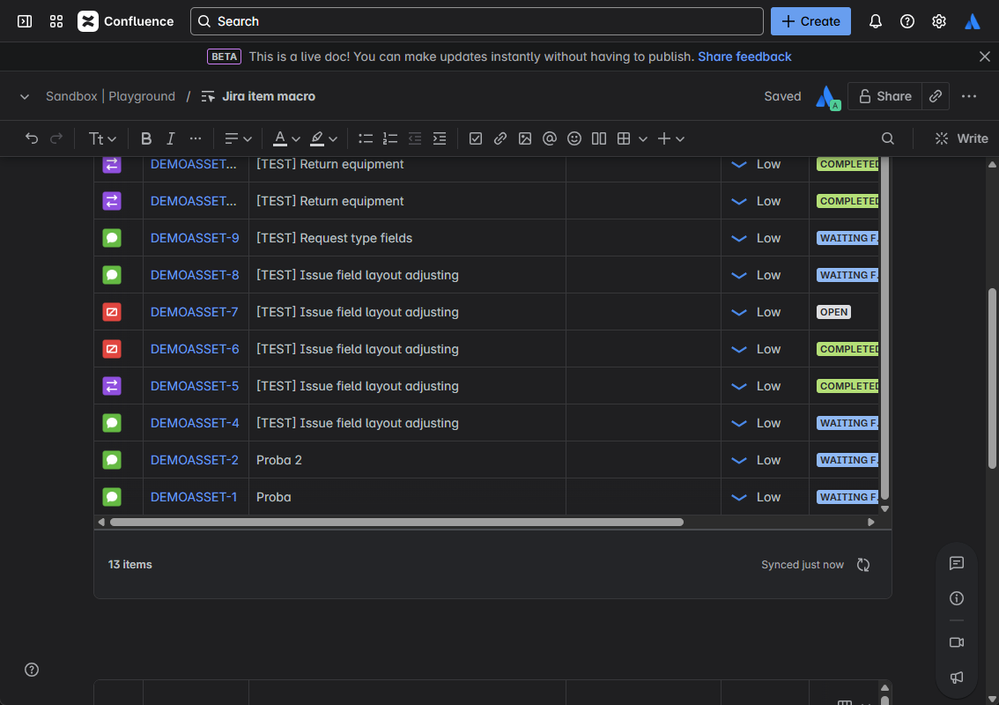

Are you using Jira issues/work items macro?
I'm not sure if they did any minor backend changes that would result in this UI change, but you should now be able to see the total number of items displayed in the filter.

So, I've just tested this (by using Jira legacy macro) and it seems it's now displaying a total number of items/issues in the search query.
