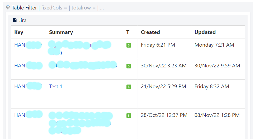

I added a jira macro and then added a table filter macro to further filter out the records in view mode. In edit mode I see the Jira macro inside the table filter macro and I am able to edit the settings too for both the macros.
But when I save the page and view, I dont see the table filter macro fields.

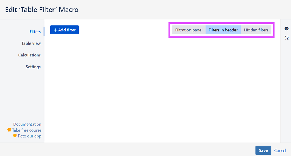

Then go to the Table Filter macro settings and check what filters' mode you have: "filtration panel" or "filters in headers". Maybe you have the "hidden filters" mode switched on - then you won't be able to filter you Jira Issues macro in the page view mode.

The macro is properly wrapped. Check the screenshot shared on other answer.
The second screenshot that you are showing is not what I see in 'table filter' settings. Note I dont have stiltsoft extensions.

Siddharth Dhotre
December 20, 2022
Here it is

Hi, I see that your Jira Issues macro is wrapped in the Table Filter macro but could you please take a screenshot of the Table Filter macro settings?
Now from its icon it seems that it is not our Table Filter macro and you have also said that you don't have any apps from Stiltsoft.
So, we need to define what macro you are trying to use - there is no any filtering options in Confluence natively. The macro should come from other vendor then or was developed in your company as a custom user macro.
It may not support the Jira Issues macro at all as it is a dynamically changing table.
But again for us to give any advice, we need to see the macro settings.

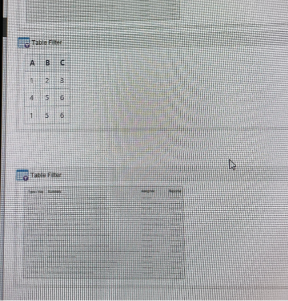

Please share the screenshot of your confluence page View source. i.e. click on page action button --> Advanced details --> View source
Siddharth Dhotre
December 7, 2022
Here it is
