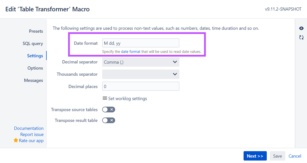

Hi @Megan ,
Seems that your SQL query is correct but you need to check the Date format inside the Table Transformer macro (Settings tab -> Date format field):

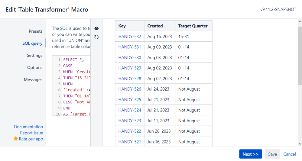

SELECT *,
CASE
WHEN 'Created' >= "Aug 15, 2023" AND 'Created' <= "Aug 31, 2023"
THEN "15-31"
WHEN
'Created' >= "Aug 01, 2023" AND 'Created' <= "Aug 14, 2023"
THEN "01-14"
ELSE "Not August"
END
AS 'Target Quarter'
FROM T1
Sat 1-2.pngHope it helps your case.
