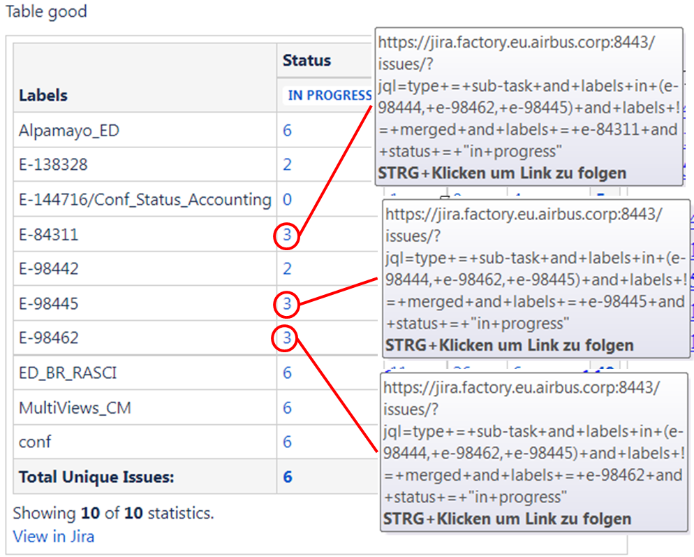

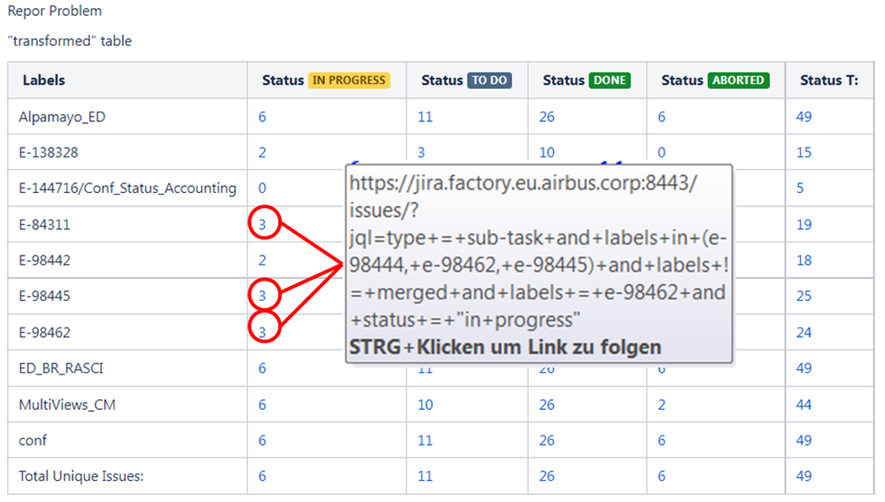

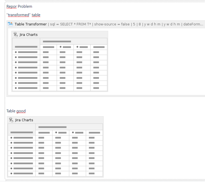

Hi,
On my Conlfuence page I have a Jira Chart Macro displayed in Two Dimensional (labels vs Status) which shows the right column-line  match when opened up in Jira.
But when I place the same Jira Chart macro into a Table Transformer macro the lines having the same number in the same column has the same Jira link behind them (when opened up).
Any ideas why it is happening and how to fix it? We are using Atlassian Confluence 7.4.1 version and I do not have the means to update it to newer.

So I finally managed NOT to reproduce it on my side :) Somehwo the "labels = merged" part in the jira search makes the problem. Using the "merged" word in the jira filter causes the glitch.
Do you know by any chance what is the programing behind the Table Transfo macro? It seems like the "merged" word in the jira filter makes the same numbers merged. The Table Transformer macro takes it as a command.
