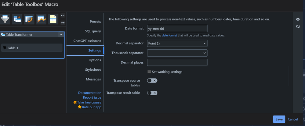

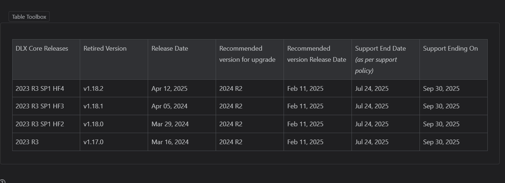

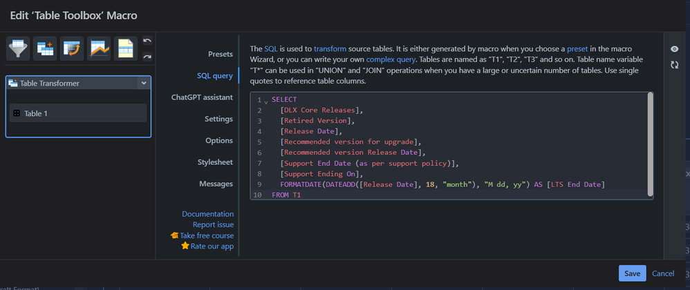

I am trying to add a calculated field name 'LTS End Date" which takes "Release Date" and adds 18 months to it and shows the new date in "LTS End Date" column. Maybe I am doing something wrong with the query as I am getting blank values (Preview image).

Meanwhile, you may go to the Screenshot 2 and set your date format as M dd, yy (this format is used in your source table and you also want to keep it).
Then you may visit our documentation and check the syntax for the DATEADD function (the macro is based on the AlaSQL library):
FORMATDATE(DATEADD(month, 18, 'Column Name'))
