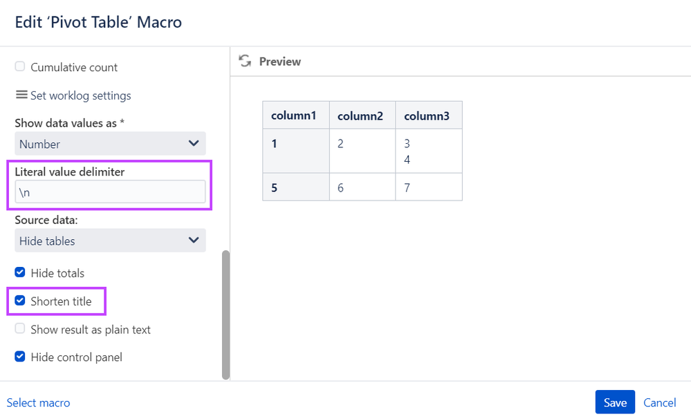

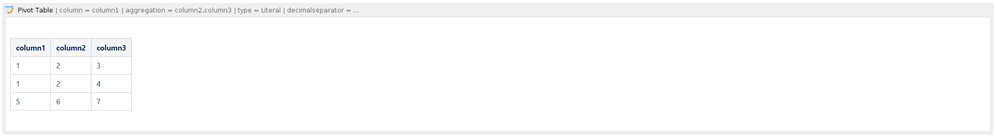

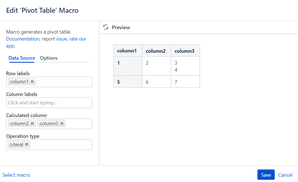

The simplest way to aggregate tables is to use the Pivot Table macro:

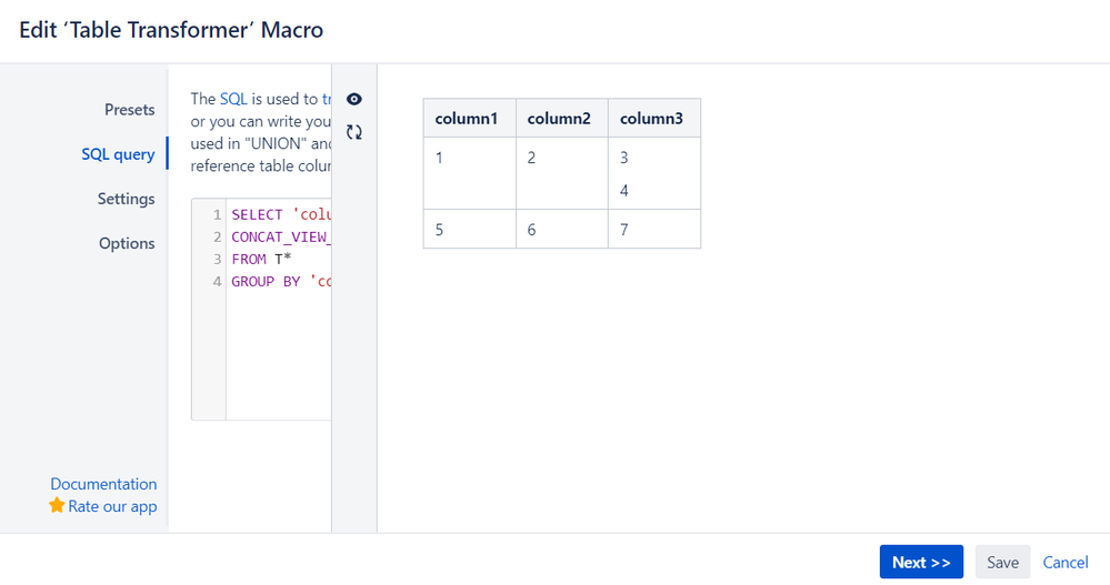

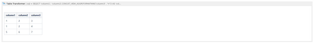

And here is another variant using the Table Transformer macro:
SELECT 'column1', 'column2',
CONCAT_VIEW_AGGR(FORMATWIKI('column3' , "\n")) AS 'column3'
FROM T*
GROUP BY 'column1', 'column2'
Hope it helps your case
