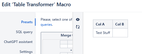

Hello, I have a Chart from Table macro in a cell of my Table (Table 1). This table is inside a Table Transformer macro and will not display the Chart in cell.
Table Transformer v12.1.1 and

Hi @Steven Amos ,
Seems that you are talking about our Table Filter, Charts & Spreadsheets for Confluence app and its Table Transformer macro.
The Table Transformer macro gets data from the source table, so to make the charts visible, you need to "draw" them beforehand in the source table.
Go to the Table Transformer macro settings -> Options tab -> Source data and choose the "Show all content" option.
Then you'll get a visible source table with charts and these charts will be also displayed in the output table of the Table Transformer macro.

This works as a workaround, but I then have duplicates of tables that I would prefer to have hidden. I tried using the "Hide Tables" option which I thought would work, but instead results in missing charts again. Is there a solution that would allow me to show just my final table with the chart rendered, and hide all the source tables?

Seems that everything works as expected here.
Besides, it is not a best practice to put tables inside tables. For example, it's impossible on Confluence Cloud. So, you may use layouts or Section/Column macros instead of the outer table. It will also help with the chart rendering but you won't be able to use an external Table Transformer macro.

The Hide tables option hides source tables.
The Hide all content option hides source tables and additional elements, for example, the refresh button and the number of issues if your source tables are Jira Issues macros.
Here comes the difference between these options.
When you select the Hide tables option, your charts can't be rendered because they are not just plain pictures in the source table but macros based on the nested tables. They should be firstly rendered and become visible. Then the Table Transformer macro gets them from the source table and operates with them.
