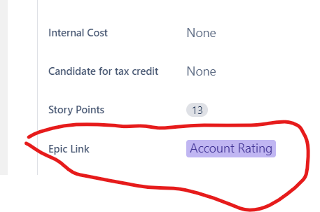

Thank you for the help.  I tried it and it did not work .  But I did get further   I now get no search results found.  I confirmed the Epic Link

It appears that your Epic Link/Epic Name is "Account Rating" with a space. If you put it in the query without a space, that would explain why no results are found.
After fixing that if you still get no results then please show us the actual filter you are trying to use.
Juan Fuentes
April 25, 2023
I cant believe over a space i had an issue.  I had assumed I had to eliminate the space when referencing the table.  I was wrong thank you it worked
