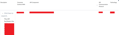

Hi, I have been working on an API catalogue of sorts.
Initially just using a page properties report, but then adding filtering
Worked really well and looked good.

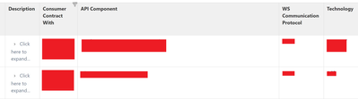

I then wanted to pull in lifecycle info from Jira into the same table , so created a Jira issues table and using table transformer to merge the tables got what I wanted.
Unfortunately there was one slight issue, the Description Column was pulling through the expand macro
that contained the description text (some descriptions were quite lengthy so needed to make the layout concise in the table view) and the expand macro no longer opens to display the description.
table merge 1.PNGtable merge 2.PNG The query used is

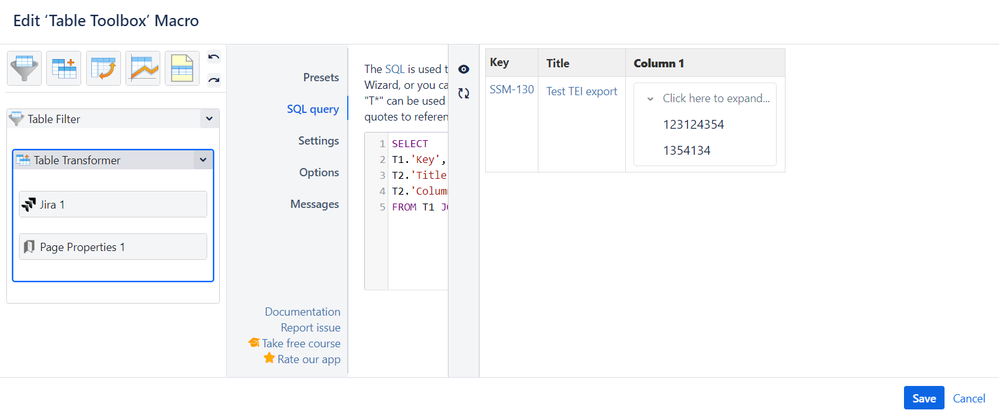

Hi @Craig_Harley ,
Meanwhile, I've tried to reproduce the issue: I've collected my Page Properties Report macro (had two Page Properties that contained Expand macros and Jira Issue macros as a single issue) and inserted the Jira macro in a tabular view.
Then I wrapped these two macros in the Table Toolbox macro and wrapped them into the Table Transformer macro for joining and then in the Table Filter macro for filtering.
The Expands are always opening for me.
So, it seems that we really need your data to investigate the issue.
Please also check where Expands break for you: do they work properly if you remove the Table Filter macro and leave only the Table Transformer macro?

November 3, 2023
Please refer to our support then.
I indeed have the similar query inside my Table Transformer macro:
SELECT
T1.'Key',
T2.'Title',
T2.'Column 1'
FROM T1 JOIN T2 ON T1.'Key' = T2.'ID'
And for me the Expand macro opens just right:
