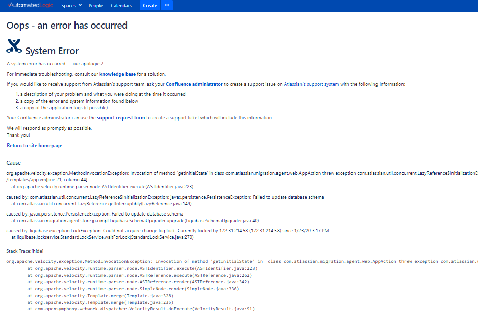

While opening the confluence server migration Assistant the below error.
Oops - an error has occurred
 System Error
A system error has occurred — our apologies!
For immediate troubleshooting, consult our knowledge base for a solution.
If you would like to receive support from Atlassian's support team, ask your Confluence administrator to create a support issue on Atlassian's support system with the following information:
  1. a description of your problem and what you were doing at the time it occurred
  2. a copy of the error and system information found below
  3. a copy of the application logs (if possible).
Your Confluence administrator can use the support request form to create a support ticket which will include this information.
We will respond as promptly as possible.
Thank you!
Return to site homepage…
Cause
org.apache.velocity.exception.MethodInvocationException: Invocation of method 'getInitialState' in class com.atlassian.migration.agent.web.AppAction threw exception com.atlassian.util.concurrent.LazyReference$InitializationException: javax.persistence.PersistenceException: Failed to update database schema at /templates/app.vm[line 21, column 44]
    at org.apache.velocity.runtime.parser.node.ASTIdentifier.execute(ASTIdentifier.java:223)
caused by: com.atlassian.util.concurrent.LazyReference$InitializationException: javax.persistence.PersistenceException: Failed to update database schema
    at com.atlassian.util.concurrent.LazyReference.getInterruptibly(LazyReference.java:149)
caused by: javax.persistence.PersistenceException: Failed to update database schema
    at com.atlassian.migration.agent.store.jpa.impl.LiquibaseSchemaUpgrader.upgrade(LiquibaseSchemaUpgrader.java:35)
caused by: liquibase.exception.LockException: Could not acquire change log lock. Currently locked by 172.31.214.58 (172.31.214.58) since 1/23/20 3:17 PM
    at liquibase.lockservice.StandardLockService.waitForLock(StandardLockService.java:230)

Shared the attach screen shot for your reference.
