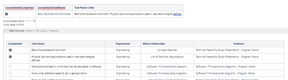

My users had a request to take some large tables with checkboxes, and create smaller linked tables where 1 of the checkboxes in the smaller table would link to the 2 or more in the larger table
As a visual example, this is similar to what I am trying to get a working proof of concept for

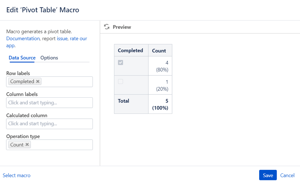

We can suggest counting checkboxes for your large tables.

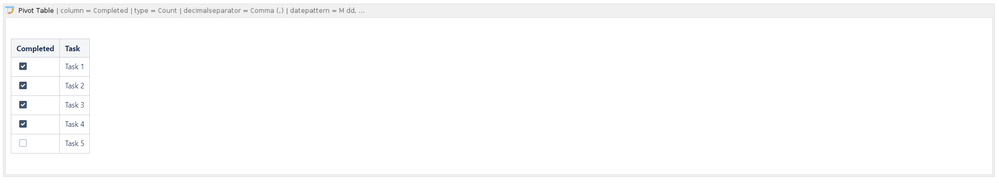

I mean that if your large table consists of many stages of the same big project, you may wrap it into the Pivot Table macro and count how many steps are left there to the whole project to be completed.
If you wrap this Pivot Table in the Chart from Table macro, you can visualize the data as a pie chart.
As you've mentioned that sometimes you need to reference not one large source table but several tables, then you need to wrap each of these tables in the Table Excerpt macro, collect them on the master page via the Table Excerpt Include macro, tick the "Show as a report" option and your tables will be shown as a combined report.
Then you wrap your Table Excerpt Include macro in the Pivot Table macro and count empty/non-empty checkboxes for the whole combined table.

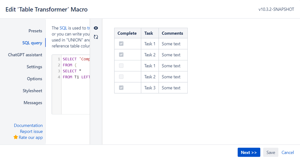

If you need to connect tables vise versa, you may use the Table Transformer macro:
Here the first table is your big table and the 2nd&3rd tables are your smaller tables.
The big table doesn't have the column with checkboxes but the smaller tables do have checkboxes.
To connect these tables, they should have a common column - for my example, it is 'Project Name'. On your screenshot there is no such column. so you need to add it (for example, add the 'ConsolidatedTaskName' in the big table).
Now we can look up these tables by the common column 'Project name' and list the columns that we want to see in a result table:
SELECT 'Complete', 'Task', 'Comments'
FROM (
SELECT *
FROM T1 LEFT JOIN T* ON T1.'Project Name' = T*.'Project Name')
As you can see, the checkboxes from the smaller tables are mirrored in the big table.
