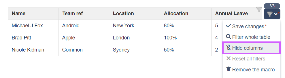

you'll need additional apps to enhance the standard Content Report Table macro.
For example, you may use the Table Filter and Charts for Confluence app and its Table Filter macro.
Wrap your Content Report Table macro into the Table Filter macro body and apply the default sorting to any column you want.
The Table Filter macro also allows you to hide columns.
Hope this helps your case.
