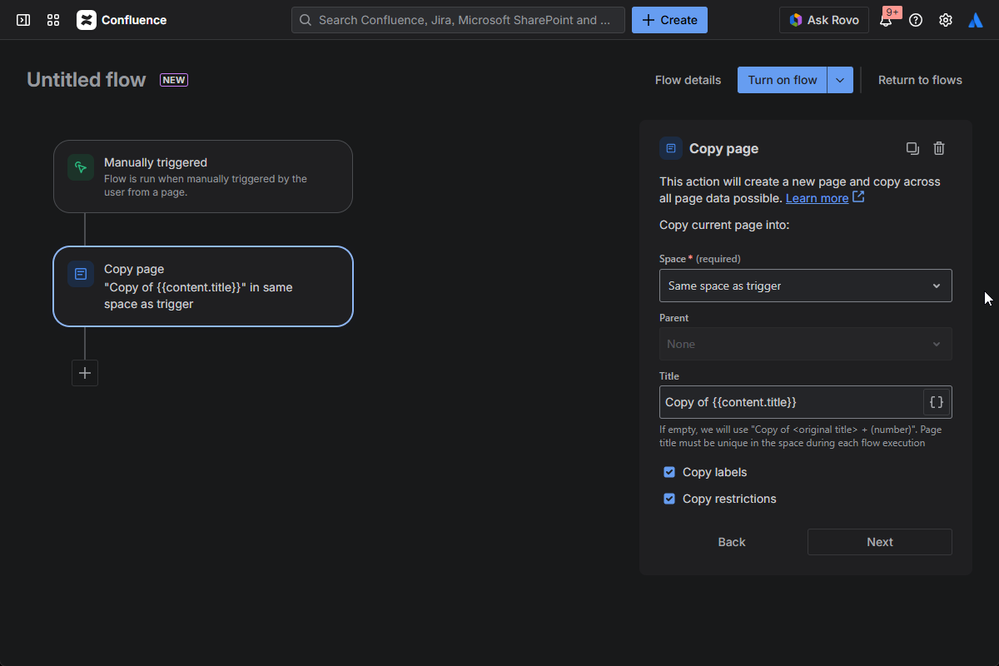

I mean... with the current approach, the only plausible way (and most efficient one) would be to use copy/duplicate option from this master template page. It's not 'a button,' per se, but a native solution to copy something.
If you'd use a simple action to copy content, would that cover it? This should preserve formatting, but it's currently not possible to add custom automations to smart buttons (see CONFCLOUD-79704)
