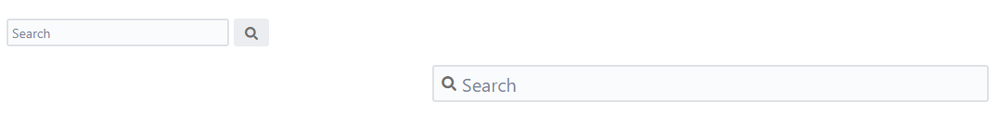

Hi all concerning the LiveSearch Macro
We noticed that the placeholder text is no more displayed since we upgraded from 7.19 to 8.5
Is this a know issue?
Thanks in advance for your help on this.
With kind regards,
Pascal

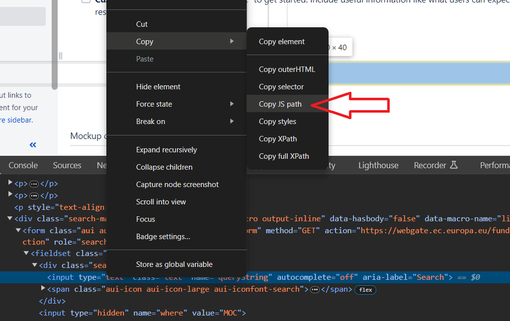

Firstly you need to Copy the JavaScript path from the html inspect properties of you input.
You'll get something like this:
#main-content > div > div:nth-child(2) > div > div > div > form > fieldset > div > input
Then you need to add at page level an html macro where you can add your JavaScript to set the missing placeholder attribute.
<script>
// added by lisotpa to bypass placeholder issue in confluence 8.5
document.querySelector("
").setAttribute('placeholder', 'Search by keywords');
</script>
Hope this will help.
Cheers,
Pascal

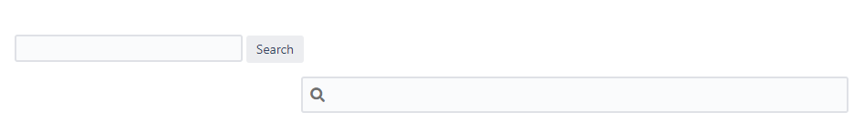

Hello, we are having the same problem with the livesearch macro. After upgrading from 7.19.12 to 8.5.x. I have gone through the atlassian-confluence.log file, but I can't find anything that indicates that anything is wrong. The live search macro is set up restricted to @self, restrict labels: none, size: large, placeholder text: "This is a test" Content type: page, additional information: "Space name"
I have tested the page/space using the Brave browser and Firefox, both fail. Operating system: Red hat Enterprise Linux 9.
