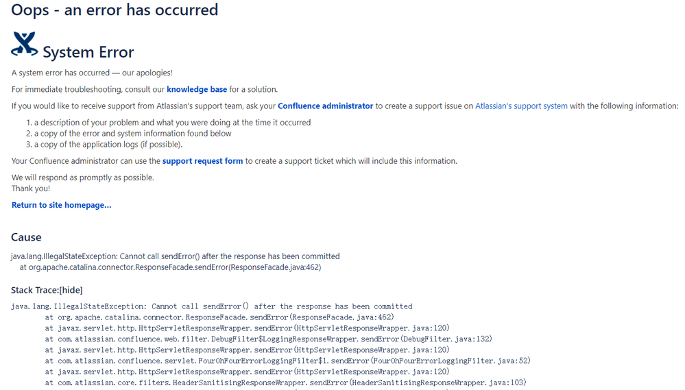

【Setup error】When I setup users on initialization,an error has occurred
shihenghui
May 18, 2020
step1,install confluence in CentOS
step2,startup confluence url and initialization
step3,configure database
step4,   choose "create user" or "import jira"
expect: open new page and success
actual:Error
So, I was looking forward to a good solution.
Thanks for your support
Best regards!

Kurt Klinner
May 18, 2020
@shihenghui
Hi and welcome to the Atlassian community
Could you check the confluence logfile to see if you find additional exceptions.
There were some issues discussed in the forum in the past, most of them related to issues with the database setup
https://community.atlassian.com/t5/Confluence-questions/Cannot-call-sendError-after-the-response-has-been-committed/qaq-p/933173
Which database system are you using?
https://confluence.atlassian.com/doc/database-setup-for-sql-server-9258.html?&_ga=2.38224163.1662637765.1589745316-2005217296.1589745316#DatabaseSetupforSQLServer-2.Createadatabaseanddatabaseuser holds the relevant information for the db setup
Cheers
Kurt
shihenghui
May 20, 2020
Hello Kurt,
Thanks for your reply.
I used CentOS 7.3 + MySql.
And I tried to find soluntion in that links,but still failed. :(
So, I input log,please check it.
Thank you again!
