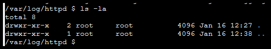

In the documentation it states that the access log for Confluence is located at /var/log/httpd/confluence-access.log. When I access the running docker container and look for that log file, it's not there. The directory /var/log/httpd is there but there is no log file in there.

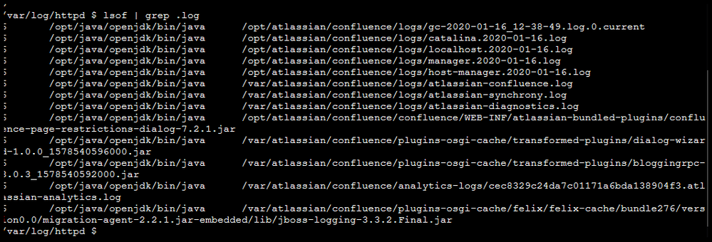

When I do a "lsof | grep .log" I can't see any open log files called "confluence-access.log".
Do I need to turn on access logging or something? Has anyone been able to get fail2ban working with the Confluence Server Docker Container?

The article you shared mentioned that you need to point to a known log file, as the Common Configuration listed is only an example. According to the prerequisites:
  • Requires Python 2.4 or higher to be installed
  • Requires Apache Reverse Proxy to be installed
  • Needs a specific file to follow, which means your Apache instance needs to log your Confluence access to a known logfile. You should adjust the configuration below appropriately.
I hope that's clear, but let me know if you have any further issues.
