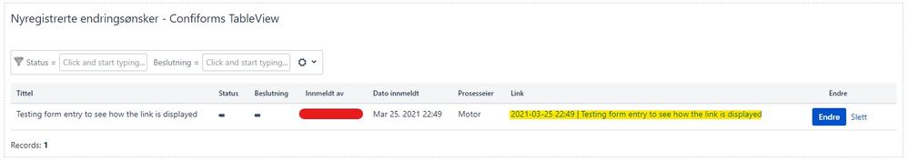

This worked fine but there is one issue when I list all of the records in the TableView Macro, the link name, or display text if you will, has an unnecessarily long format. Please see the attached photo:
Is it possible to standardize the display name so that for every record it always shows "link", "weblink", "URL" or something similar?

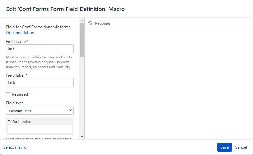

I generate the link to the created page using the field "Hidden Html". This way it's not visible in the entry form but shows up in tables/lists/calendars etc.

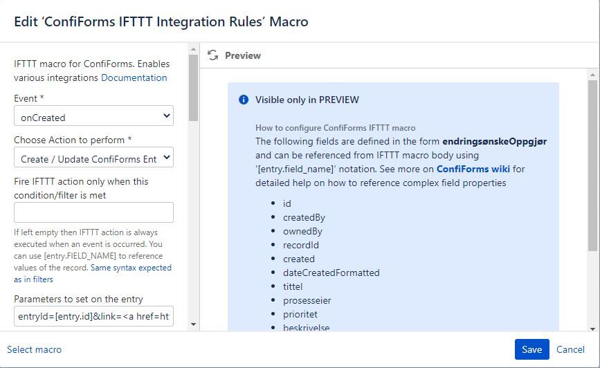

The macro that creates the link is set up as follows:
I use this parameter:
entryId=[entry.id]&link=<a href=https://confluence.intern.sparebank1.no/pages/viewpage.action?pageId=${iftttResult_0.id}>${iftttResult_0.displayTitle}</a>
Is it possible to use the asLink virtual function in this case? If so, can you please explain how?
Alex Medved _ConfiForms_
March 26, 2021
Well, not quite - is there a reason why you save back the HTML link like that?
And not the reference to page id, for example...
If you insist on saving back the HTML link then just modify it the way you need (for label), For example:
entryId=[entry.id]&link=<a href=https://confluence.intern.sparebank1.no/pages/viewpage.action?pageId=${iftttResult_0.id}>Web link</a>

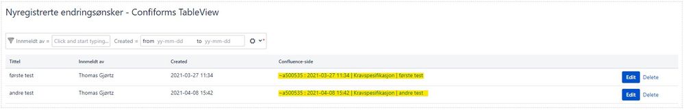

and then list all of the records in the TableView Macro, the link name/text appears like this:
As you can see the link is a combination of my username + the title of the newly created page.
Is it possible to modify the parameter so that I am able to set a custom link text?
Thanks in advance!
April 8, 2021
It's possible
In the TableView you have already, instead of a ConfiForms Field with field name set to 'createdPage' put something like this
createdPage.urlPath.asLink(I am link)
into the field name parameter
This expression uses virtual functions available in ConfiForms which help you to transform the values as you need.
Alex
