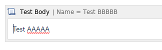

My Macro:
## This is an example macro
## @param Name:title=Name|type=string|required=false|desc=Your name
#set ($body = $paramName)
$body
Page in the edit mode
As you can see, the param is "Test BBBBB" and the body text is "Test AAAAA". The page in the view mode shows "Test BBBBB". Because when loading the page in view mode, the macro will be rendered and in the macro I defined: body=paramName.
Do you really need a body in the macro? Or could you do the same with only parameters and get rid of the body?
