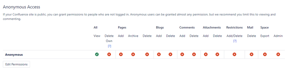

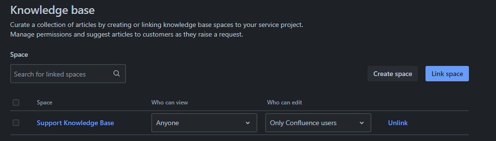

Hi Marc,
Thank you for the quick reply.
For your guide:
Service Portal Knowledge base access
Confluence Knowledge base access
This is what you are referring to?
From my knowledge and the articles available, this should be correct.
I'm also quite sure it worked after our migration a few weeks ago.

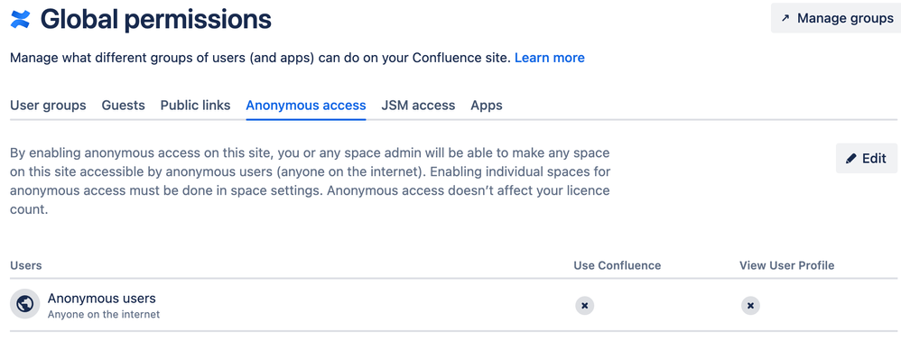

Hi @Jesper
Is you Confluence global permission also enabled for anonymous access, as this is required based on the option you have set?
Global Permission setting in Confluence, that should be enabled: "Use Confluence" (I don't)
I never use this setup. I always use the second option, to not have my whole Confluence to be set anonymous accessible.

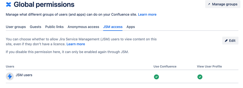

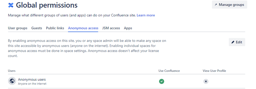

Hi @Marc -Devoteam- ,
Just for my understanding, does your Confluence require a user to log in to access any space/page? Or am I misunderstanding?
We have a single space that is open to the public, the reset is log-in required.
So indeed, I do have it set so Anonymous Users can use Confluence.
And the space works, they can access it and browse it - they just can't search if they are logged in to the Service Portal.
To me, it seems like Atlassian keeps our customers logged in and gets confused over permissions.

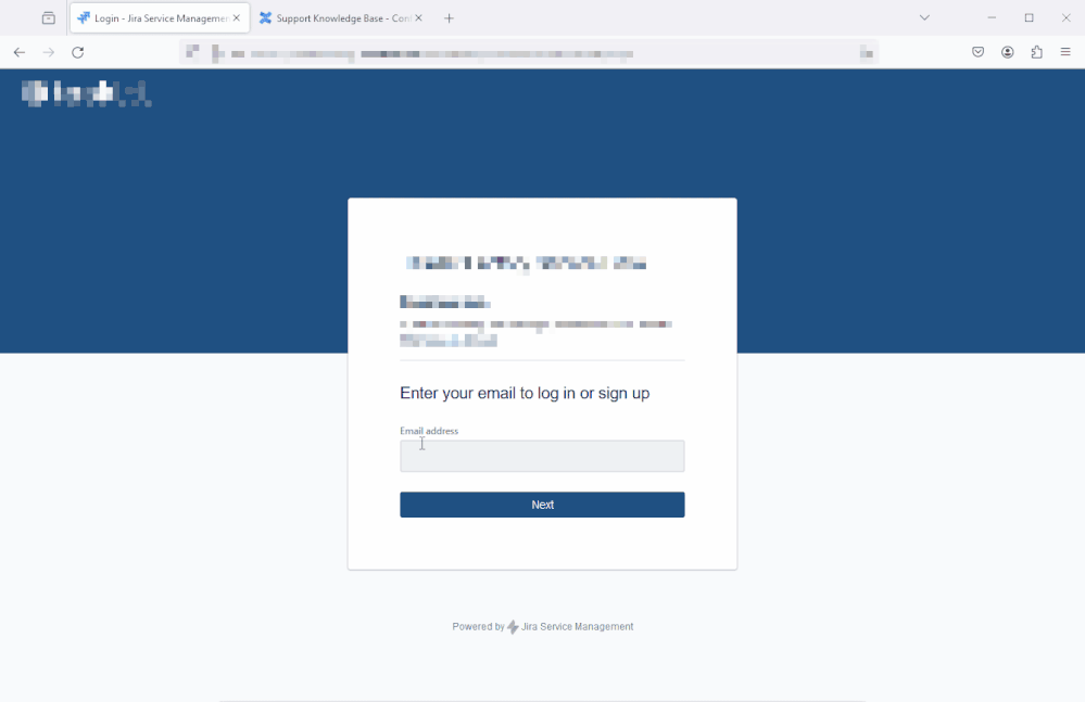

I want to say I fully understand you, but at the same time, I want to double check :)
I want to make clear, that none of our customers log in to Confluence.
You can see the problem in the GIF below.
1. Customer isn't logged into Service Portal, and can search in Confluence.
2. Customer logs into the Service Portal and now can't search within Confluence
3. Customer logs out of Service Portal and can search within Confluence again.
And if you look in the top right corner, at no point is the Customer logged into Confluence.
So one would expect them to be anonymous users, right?

Just to follow up, being unable to search as shown in the GIF above - is that normal behavior, and how Confluence should work if a customer is logged into the service portal?

Hi @Jesper
Yes.
As the user is logged in, the user is not anonymous anymore.
Customers are registered in your cloud instance, so when logged in they are not considered as anonymous users.
