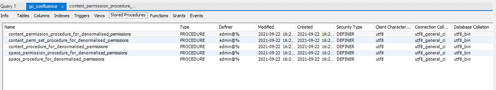

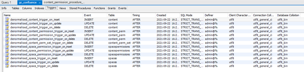

March 14, 2023
Thank you,
I tried all of these posts and all works on database and tables, but not on the TRIGGERS and Stored Procedures.
You can have a look at the images bellow.
Thank you for help.
