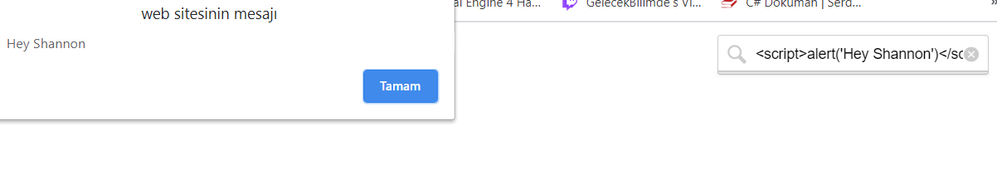

umit.unal
April 2, 2020
Hi Shannon,
Please go to docs.zerodensity.tv and find the search bar on top right.
Thanks!
Umit

umit.unal
April 1, 2020
Hi Shannon,
Thanks for your answer! It's very simple script like <script>alert('1')</script>. I could not believe in my eyes..
SMS

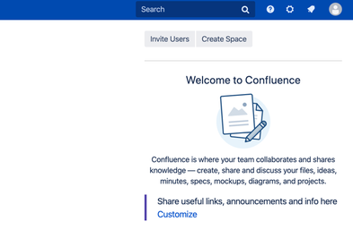

April 2, 2020
Hi Umit,
Thank you for providing that screenshot and the example of the script.
Can you let me know what search bar that is? The Confluence search bar looks like this:
The example you sent me doesn't look familiar. Can you let me know where within Confluence I should go to replicate your issue?
