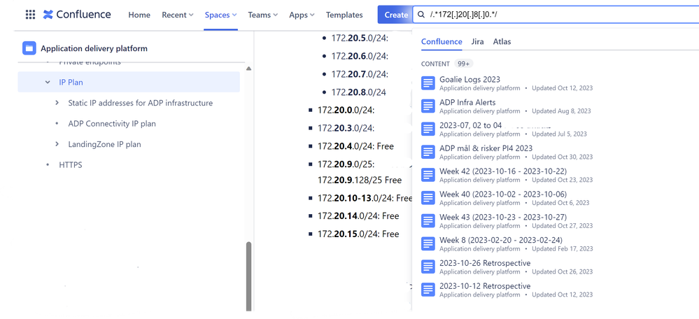

It does not work very well either. Here is an example from our Confluence. I have navigated to our IP Plan and that page is not one of the 10 pages that comes up in the search.
Do you know if someone has asked for an improvement or fix on this? Not being able to search for IPs in such a well-known and widely used service as Confluence is surprissing!
