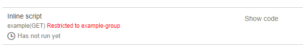

However, when i include the @PluginModule annotation, the endpoint in ScriptRunner becomes invalid.  When i try to hit the endpoint, I get a 404. In my configuration,
What a valid endpoint looks like in my configuration:api-endpoint-example.PNG
What the endpoint using @PluginModule looks like in my configuration:

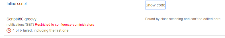

@Stephen Cheesley [Adaptavist] after not running the code for a while, it started giving the following error :
message: "Cannot invoke method findAll() on null object",
stack-trace: "java.lang.NullPointerException: Cannot invoke method findAll() on null object at Script486$_run_closure1.doCall(Script486.groovy:21) at com.onresolve.scriptrunner.runner.rest.common.UserCustomScriptEndpoint.doEndpoint(UserCustomScriptEndpoint.groovy:308) at com.onresolve.scriptrunner.runner.rest.common.UserCustomScriptEndpoint.getUserEndpoint(UserCustomScriptEndpoint.groovy:195) ",
status-code: "INTERNAL_SERVER_ERROR"

Here's what the configuration looks like now:
Also , I haven't changed any of the code, or have even updated it from what you see above.
