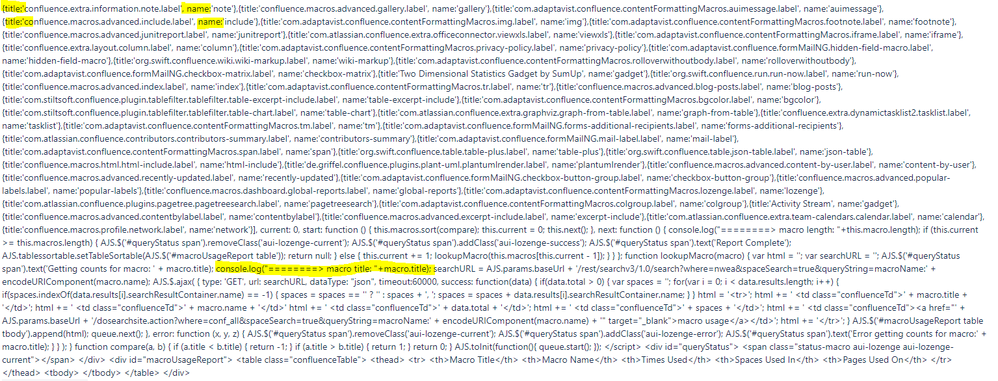

Hello @Davin Studer, I tried your code on Confluence 6.8.2, and while it runs and I can see the list of macros, the page I have this on will not render the HTML output. This is what the page renders:
Which of the 'Macro Body Processing' options does your macro require?
Also, how can I debug and log to a file from within a user macro? console.log either isn't working or isn't getting to my code, but I do have a log stmt as the first line in my javascript tag.
Thanks
When this answer was ported from the old Atlassian Answers site the code code HTML encoded. Thus things like < > and & ended up getting changed to < > and &. So, you would just need to do a find a replace to fix it. However, since you are on 6.8.2 you should have access to a new-ish report that they put in Confluence Administration that provides basically the some information. It's toward the bottom and is called Macro Usage.

I've fixed the code in the above post so it should be correct now.
Thanks Davin, I noticed the code was escaped but I thought it was deliberate, like when encoding a url. That made it render, so thank you!

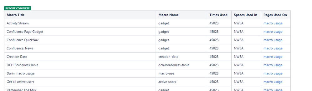

Hmm, I might have messed something up by just trying to clean up the HTML encoding. I re-inserted the code above from the source in my Confluence instance. Give that a try.
Thie info this macro shows is wrong for the "Spaces Used" column. The calls this macro makes only returns 10 actual results (plus the correct total) so the "Spaces Used" number is wrong for any macro in use in more than 10 pages. To do this correctly, it would have to page through every result and it doesn't do this.
@Davin Studer we have upgraded our confluence to 7.3.5 and the macro seams to stop working (not getting any results). If you have a updated version I would love to use it :)
Atlassian disabled some features that I was using in the user macro and there is no other way to do it. However, one thing to note is that there is now a macro usage report in Confluence Administration. It gives you much of the same data as my user macro did.

@Davin StuderThank you for getting back. Good to know about the in app 'Macro Usage' feature. I was using this user macro to know the 'Spaces' information, which is missing in the in app feature. I will see if I can find a workaround. Thanks again for taking a look.
