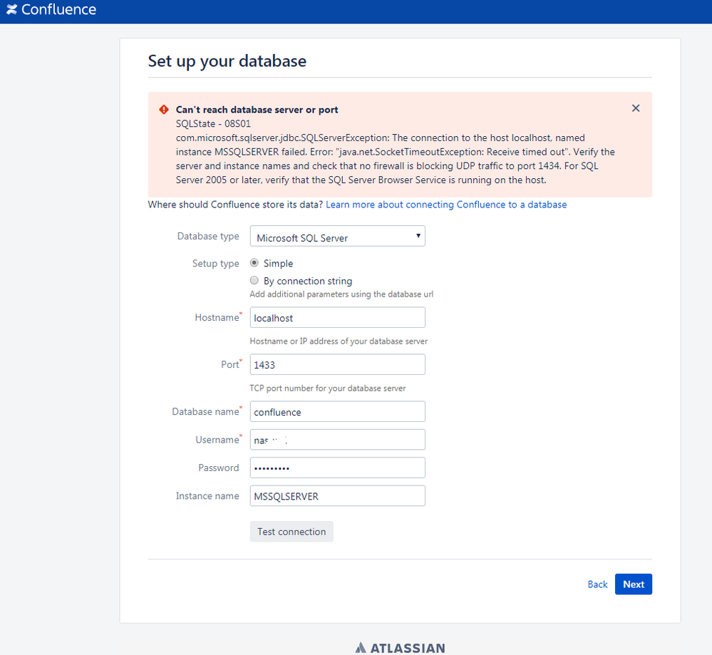

After completing the installation on docker, In browser, run setup fine (after enter license key) then database setup, the error coming out all times:
Can't reach database server or port
SQLState - 08S01
com.microsoft.sqlserver.jdbc.SQLServerException: The connection to the host localhost, named instance MSSQLSERVER failed. Error: "java.net.SocketTimeoutException: Receive timed out". Verify the server and instance names and check that no firewall is blocking UDP traffic to port 1434. For SQL Server 2005 or later, verify that the SQL Server Browser Service is running on the host.
 Very likely the cause is "For SQL Server 2005 or later, verify that the SQL Server Browser Service is running on the host."   SQL Server Browser Service status in container can be viewed? any possible solution?
Anyone can help to resolve this issue?
Thank you.

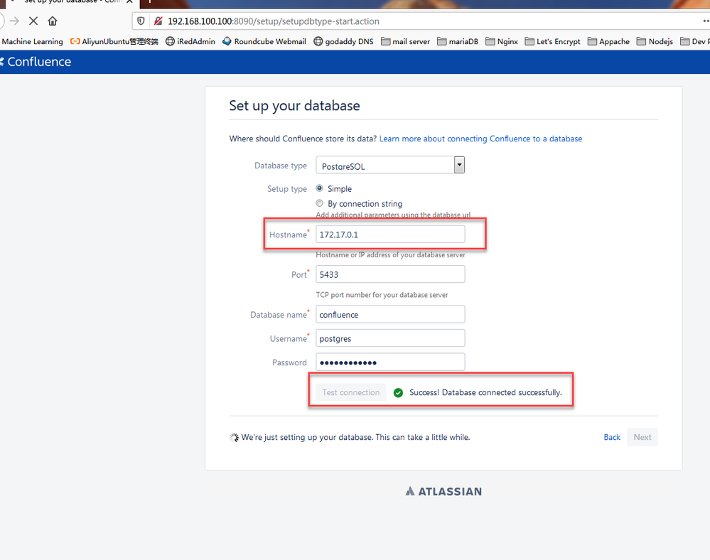

Resolved for Postgres, not MSSQLSERVER: share with other who use DSM Synology - once you get inside, a very great tool!
Read one article in the site talking about creating a docker net that should be the solution. I am not building it yet.  So far working now.

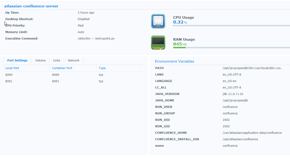

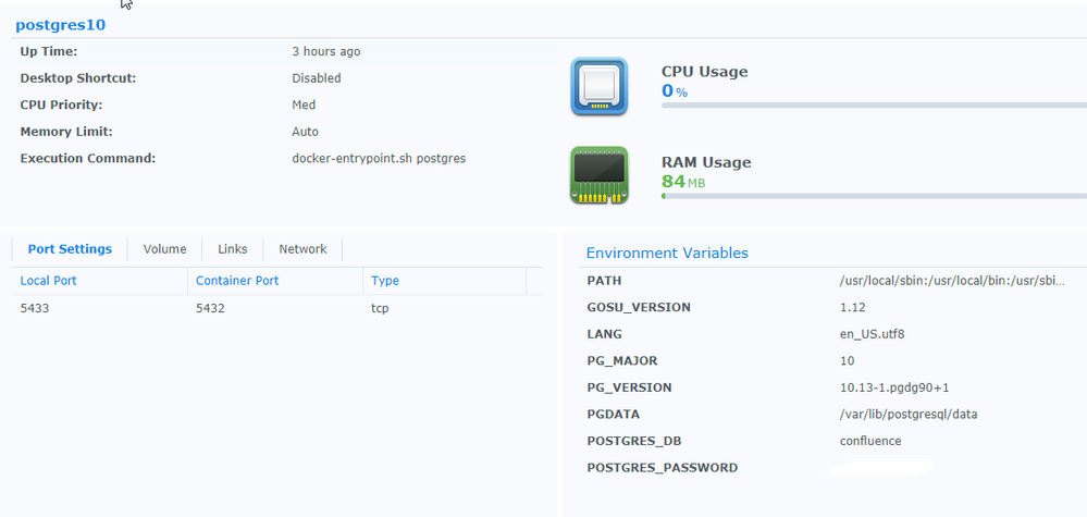

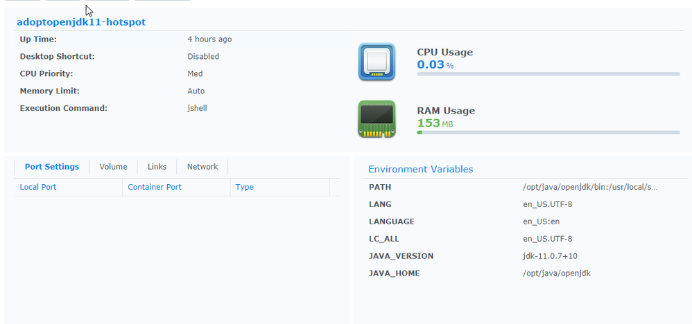

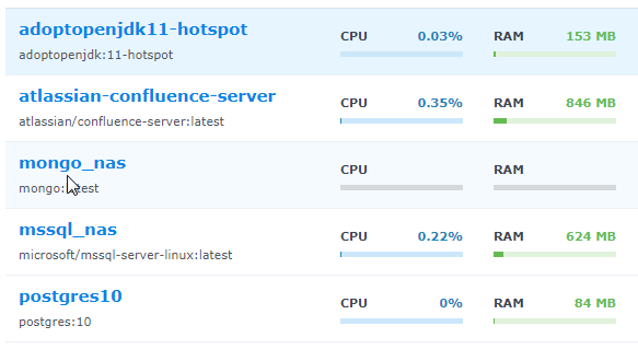

Installed in Synology Docker:
openJKD (hotspot supported) not sure it is being used by related confluence and db or not:
Postgres10 (supported by confluence)
Confluence: latest
Conventionally failed connecting this way:
You look postgre:

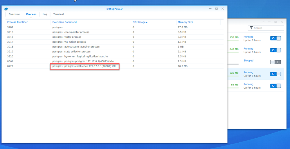

Successfully connected using 172.17.0.1
This caused me a couple of days to try many options to find out a solution. Likely guru may provide NAS public user a guide - how to setup a docker net bridging simply confluence and database (at least workable on postgres).
At this step no need to change (no changes on pg_hba.conf nor postgresql.conf).  I am not sure after reboot, the 172.17.0.1 would be changed or not. At least, Synology DSM users can save a lot of time very smoothly pass the connection troubles.

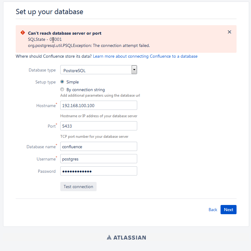

For PostgreSQL: now turned to the error:
SQLState - 08001
org.postgresql.util.PSQLException: The connection attempt failed.
The login user has been temporally fully granted as a super user still failed.

postgres works fine and the above shared screenshots should be helpful for those Synology NASers. Thank you Mo!
