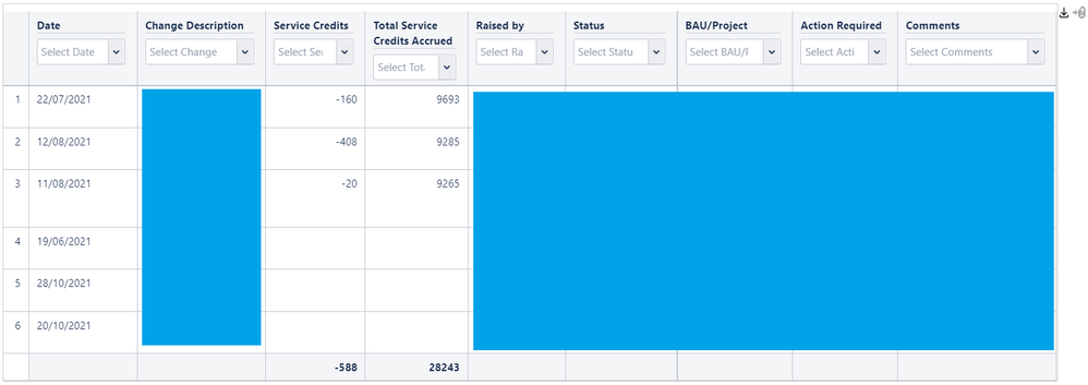

Hi everyone,
I have a table 9 column table in Confluence. Two of the columns are numeric with a total sum applied.
The use case is:
Column A: Service Credits - values are debits.
Column B: Total Service Credits Accrued - values are credits.
With each new entry into column A, I need to subtract that value from the running total in  column B.
Both columns should also have a total sum of at the footer of the table.
I have applied a Table Transformer, but I do not know the SQL query to do product this outcome. Can someone please share this with me or tell me if there is another Macro/way to accomplish this?

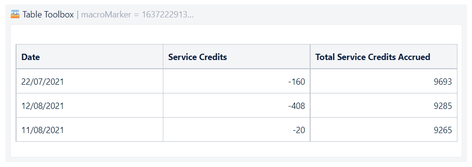

Please follow these steps: wrap your table into the Table Toolbox macro.

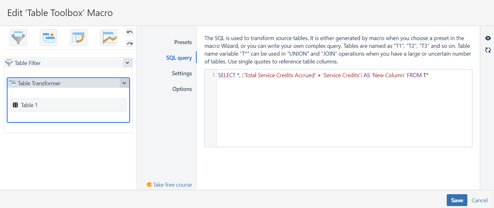

Then go to to the Table Transformer macro and use the following SQL query:
SELECT *, ('Total Service Credits Accrued' + 'Service Credits') AS 'New Column' FROM T*

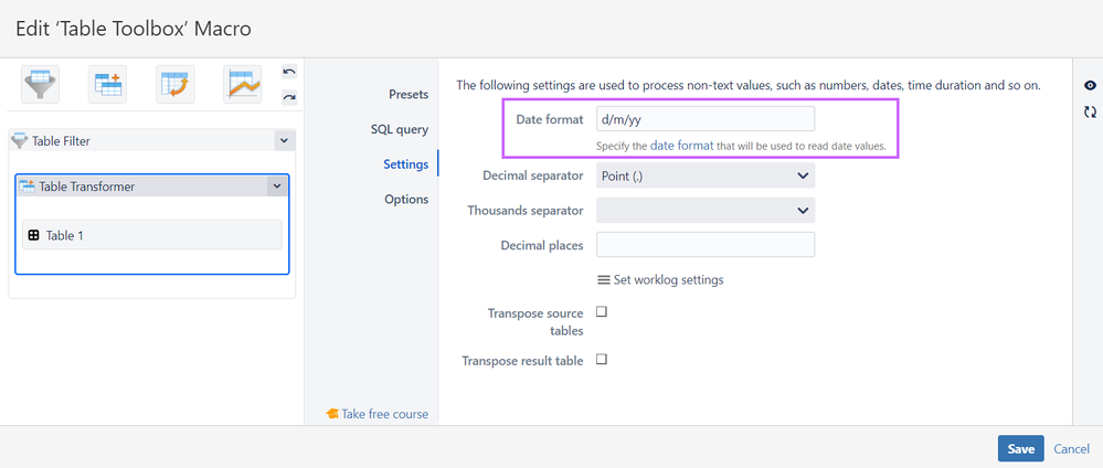

Go to the Settings tab and set the corresponding Date format:

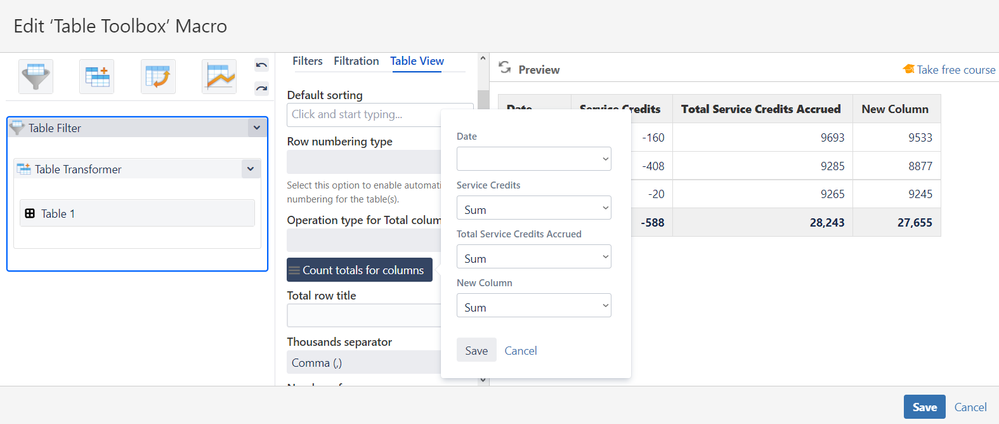

Then go to the Table Filter macro settings and select the columns where you want to count the totals:
