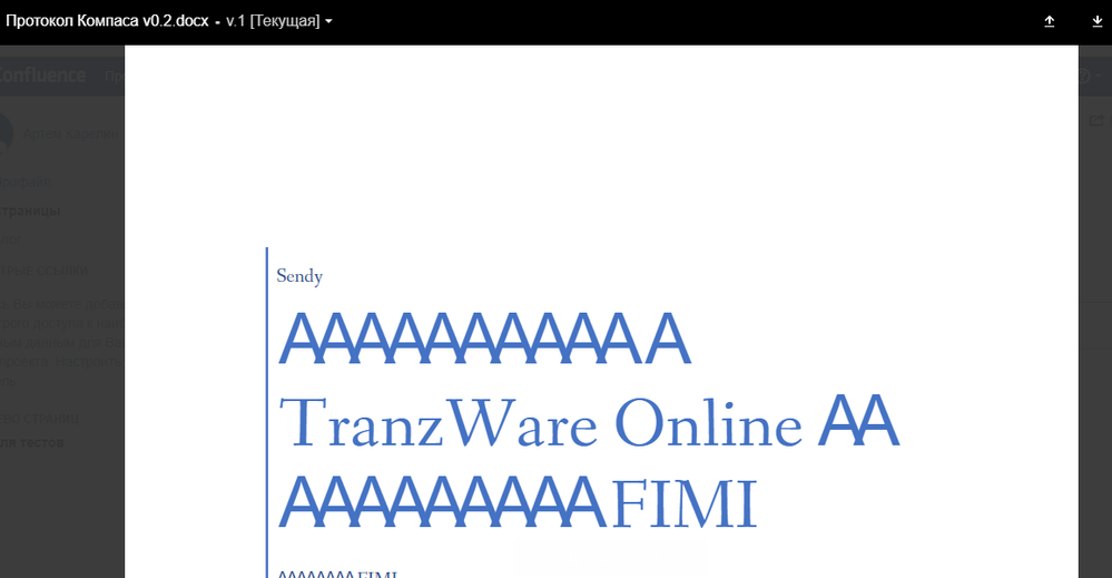

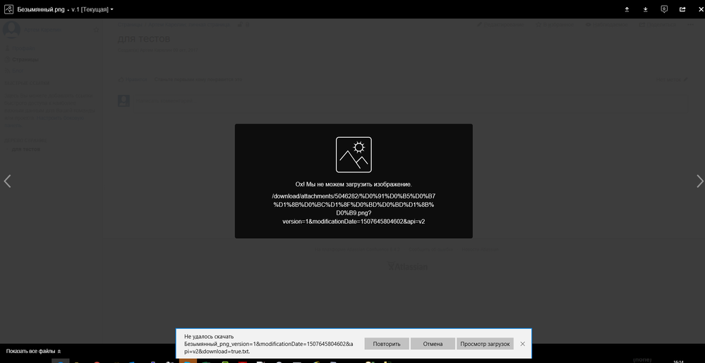

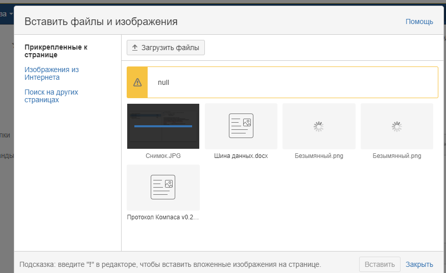

 Russian language in attached documents
Russian language in names file upload
Confluence was originally installed on a Windows server with built-in DB, there were no such problems. After installing on CentOS and migration of the database, problems with the Russian language appeared. The texts on the pages are displayed correctly

бекапим базу
создаем новую https://confluence.atlassian.com/adminjiraserver073/connecting-jira-applications-to-postgresql-861253040.html#ConnectingJIRAtoPostgreSQL-1.CreateandconfigurethePostgreSQLdatabase
только вместо С явно указываем en_US.UTF-8
ресторим базу

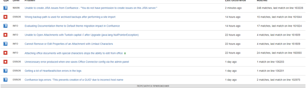

1. Could you provide LC_COLLATE info? (It will be good if it the same with ctype)
2. it will be nice if you provide stacktrace from catalina.out.
3. Which errors provides support tools analyzer?

Did you ask for this information?
I'm not an expert in these applications
Thank you
