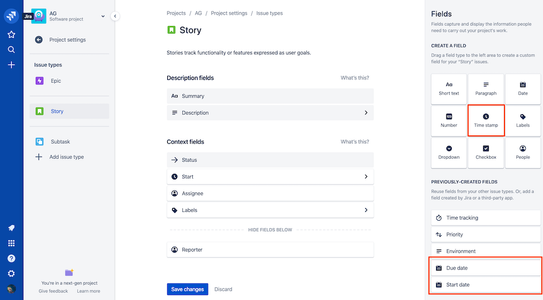

  1. Yes you can define custom fields of type 'Time stamp' and give them names like 'Start date' and 'Due date' or whatever you want to call them.  To do this you will need to go into the project settings -> Issues Types.  Then pick the issue type that has these dates.  You mentioned these were Tasks, but it could be Story, or subtask depending on your project.  You can then use the far right menu to add a Time Stamp field for this use, like so.
    You might check the bottom right corner first just to see if perhaps there are already fields by this same name and use those, rather than having to create each field manually.
