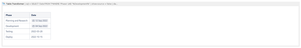

Or maybe the following case will suit you: for example, I reuse a table via the Table Excerpt/Table Excerpt Include macros but want to show only one specific cell as plain text.
So you may wrap this Table Excerpt Include (or a manually created table for my example) in the Table Transformer macro and find the required cell:

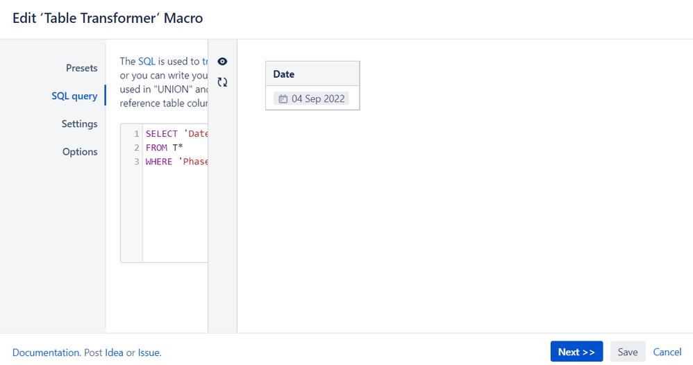

For example, here I want to show the date that corresponds the "%Development%" phase.
The result is a one-cell table with a header.

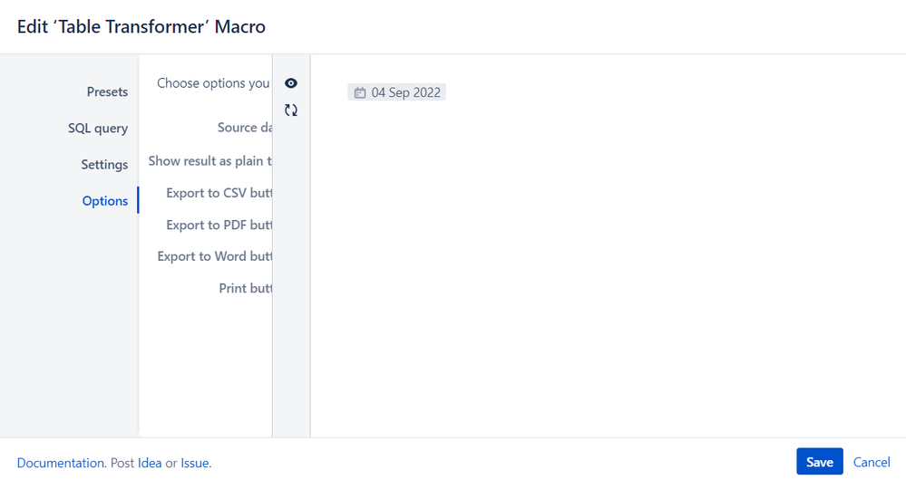

To remove the header and borders, go to the "Options" tab:
Now you get plain text as a result:
Note that if you don't see the "Show result as plain text" option, it means that you need to update the app - it's a new feature. The current version is 9.2.1 - please check and update if necessary.

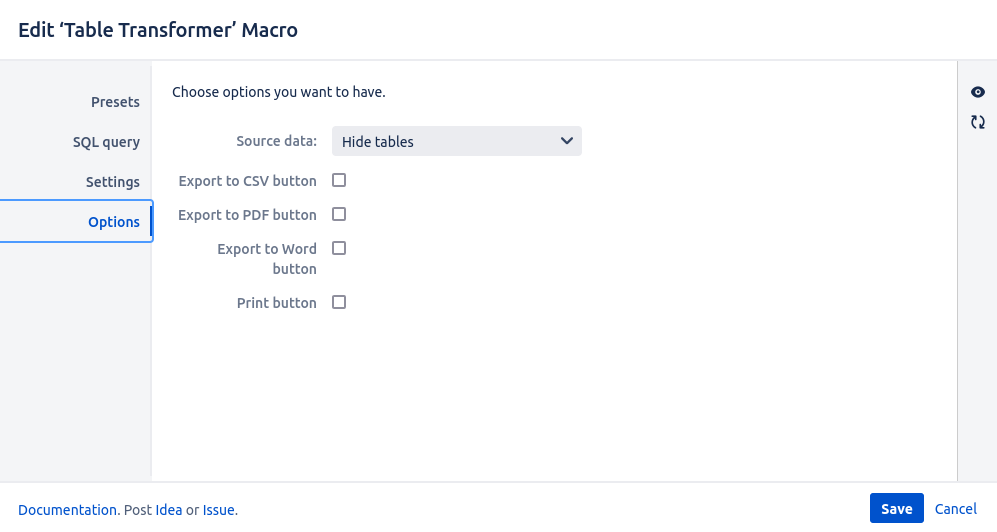

ah.... it seams like I have an "older" version:
Could I include the removal of the header and borders on the query itself?
I'm afraid this is not possible within the SQL query: at this stage the macro "sees" the source table as a mini database, so its headers are considered as crucial points and can't be removed.
The option to show the result as plain text corrects the macro output if the result table is a one-cell table automatically. This option was introduced both to the Table Transformer and Pivot Table macros, so you need to update the app.
