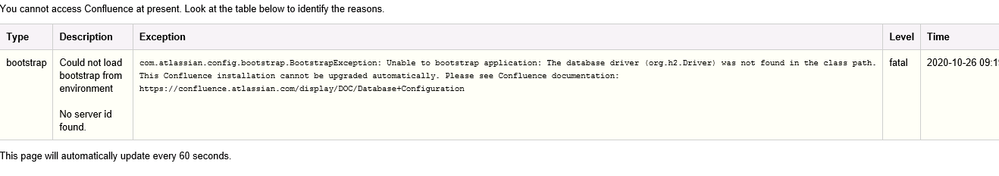

Thanks for replied, But I have got the error after installed 5.1.4 (production version) which copied from old server:
com.atlassian.config.bootstrap.BootstrapException: Unable to bootstrap application: The database driver (org.h2.Driver) was not found in the class path.
This Confluence installation cannot be upgraded automatically. Please see Confluence documentation:
https://confluence.atlassian.com/display/DOC/Database+ConfigurationInstallError.PNG
By the way, the 7.4.5 version which try to upgrading is trail version only.
So, I'm not sure what the best strategy which I could be used. Could I just manual copy the database which includes users and attached files?
I look forward to hearing from you.
Best Regards
Wei Lin
Nic Brough -Adaptavist-
October 26, 2020
You have a broken installation of Confluence there, someone has removed things from it.  You'll need to start with a fresh clean install of 5.1.4 from scratch, without whatever "clever" customisations have been done to production.

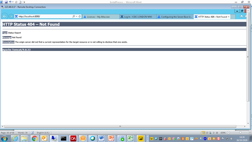

Thank you so much for your quick replied and I have managed to install 5.14 the made migration from old server successfully !
But the upgrading to 7.4.5 has been failed and got those message:UpgradeError.PNGSo, any idea on it?
Also, how I can back to 5.1.4 when this upgrading failed?
Thanks in advance.
Kind Regards
Wei Lin
October 26, 2020
You'll need to read the application log to find out what has failed during starting the new system
