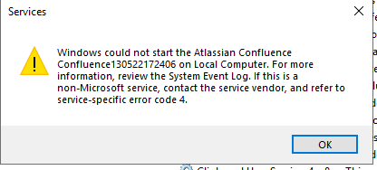

thanks for your help. I tried the steps you mentioned. When I tried to restart Confluence, it was unable to. I got the following popup:

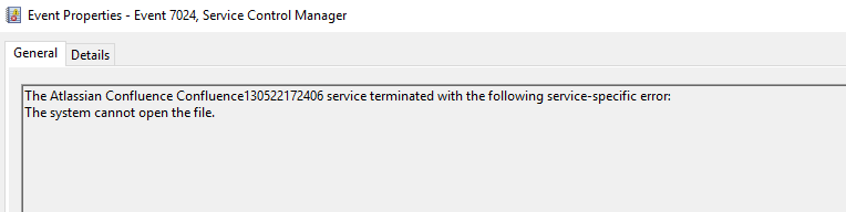

I went to the System Event Log and found the reason why it's failing:
It mentions the system can't open the file, but I'm not too sure what file it's referring to. I checked the config files and they're all there. I was wondering if you know what file it refers to when trying to restart the service?

@IT Support I am assuming you installed a fresh instance of Confluence and got that up and running.  I am also assuming you copied files from the old instance.  All the files you copied most likely have permissions set on them by the old server.  You will just need to make sure that they can be read on the new server by the service account running confluence.
