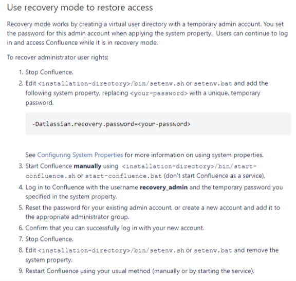

Hi, I forgot my Confluence (self-hosted) admin password and I tried to reset by following this link https://confluence.atlassian.com/doc/restore-passwords-to-recover-admin-user-rights-158390.html
I followed there steps:
1. Stop Confluence Windows Service
2. Edit <installation-directory>/bin/setenv.bat and add the following system property
set CATALINA_OPTS=-Datlassian.recovery.password=Temp_pass123 %CATALINA_OPTS%
3. Start Confluence Windows Service
4. Log in to Confluence with the username recovery_admin and the temporary password I specified in the system property.
But unable to login.

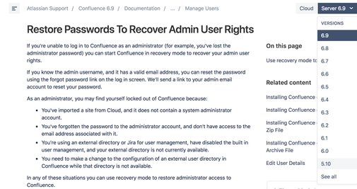

Please make sure you are using Confluence 6.5 or above. If you are using an earlier version please follow the password recovery article that corresponds to your version. The docs only go back to Confluence 5.10. If you are using a version earlier than that, please use the SQL queries from the Confluence 5.10 document.
You mentioned nothing happened when you used start-confluence.bat to start Confluence, in an Explorer window using "run as administrator". The expected behavior is a command window will open with Tomcat start-up messages, then Confluence becomes available in a browser. If you close that command window, Confluence will shut down.

Mechlin
May 22, 2018
I just installed latest version (6.9.0) few days ago on Windows 10 system and trying to recover admin password by this documentation link. Below is a screenshot of steps:
I don't no why start-confluence.bat not executing when I run it just blink a console windows nothing else.

Thomas Schlegel
May 22, 2018
Hi @Mechlin,
the documentation says:
 (don't start Confluence as a service)
