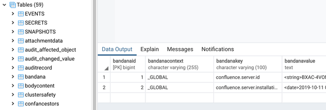

Preliminary Investigation
  • The table bandana did exist and there were data in it

      -rw-r----- 1 confluence confluence 0 Oct 11 03:37 lock
      drwxr-x--- 2 confluence confluence 4096 Oct 11 03:36 logs
      drwx------ 2 confluence confluence 16384 Oct 11 03:35 lost+found
      drwxr-x--- 2 confluence confluence 4096 Oct 11 03:37 plugins-cache
      drwxr-x--- 5 confluence confluence 4096 Oct 11 03:37 plugins-osgi-cache
      drwxr-x--- 2 confluence confluence 4096 Oct 11 03:37 plugins-temp
      drwxr-x--- 3 confluence confluence 4096 Oct 11 03:37 shared-home
      drwxr-x--- 2 confluence confluence 4096 Oct 11 03:36 temp
      drwxr-x--- 2 confluence confluence 4096 Oct 11 03:37 webresource-temp
    • Because I used official docker image directly, according to https://bitbucket.org/atlassian-docker/docker-atlassian-confluence-server/src/84d6dee89eb2bdabe189be9e15b9369a02b444e6/Dockerfile#lines-38:43, only logs, temp and work folders under ${CONFLUENCE_INSTALL_DIR}, which is /opt/atlassian/confluence/ are owned by confluence use
      # ls -l /opt/atlassian/confluence/
      total 244
      drwxr-xr-x 3 root root 4096 Sep 10 01:41 bin
      -rw-r--r-- 1 root root 19540 Jul 4 15:20 BUILDING.txt
      drwxr-xr-x 1 root root 4096 Sep 10 01:40 conf
      drwxr-xr-x 1 root root 4096 Sep 10 01:41 confluence
      -rw-r--r-- 1 root root 5543 Jul 4 15:20 CONTRIBUTING.md
      drwxr-xr-x 2 root root 4096 Sep 10 01:40 lib
      -rw-r--r-- 1 root root 58153 Jul 4 15:20 LICENSE
      drwxr-xr-x 2 root root 69632 Sep 10 01:40 licenses
      drwxr-xr-x 1 confluence confluence 4096 Oct 11 03:35 logs
      -rw-r--r-- 1 root root 2401 Jul 4 15:20 NOTICE
      -rw-r--r-- 1 root root 2291 Sep 5 04:18 README.html
      -rw-r--r-- 1 root root 3334 Jul 4 15:20 README.md
      -rw-r--r-- 1 root root 1202 Sep 5 04:18 README.txt
      -rw-r--r-- 1 root root 7025 Jul 4 15:20 RELEASE-NOTES
      -rw-r--r-- 1 root root 16738 Jul 4 15:20 RUNNING.txt
      drwxr-xr-x 4 root root 4096 Sep 10 01:41 synchrony-proxy
      drwxr-xr-x 1 confluence confluence 4096 Oct 11 03:36 temp
      drwxr-xr-x 2 root root 4096 Sep 5 04:18 webapps
      drwxr-xr-x 1 confluence confluence 4096 Oct 11 03:35 work
Could anyone help to see what could be the solution? Thanks.
