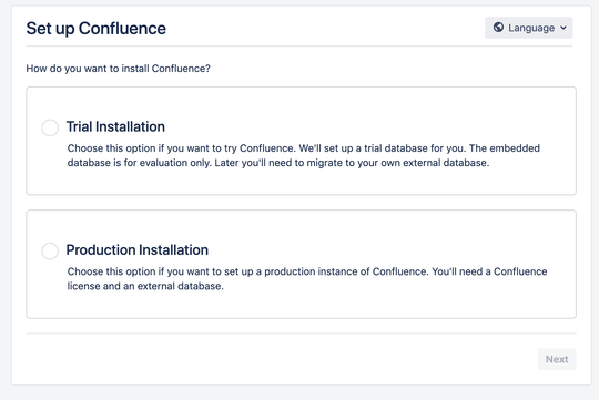

Here's a screenshot of the install wizard:image.png
The explanation text reads "Choose this option if you want to try Confluence. We'll set up a trial database for you. The embedded database is for evaluation only. Later you'll need to migrate to your own external database."
I can see how this could be overlooked though as the text is smaller than then header and it's the top option.
We do have a documented process for converting the embedded database to PostgreSQL however! It is documented on this knowledgebase article. Given your server size and that you recently upgraded, instead of step #4 in the article, I would recommend:
  1. Shut down Confluence
  2. Remove the <confluence_home>/confluence.cfg.xml file
  3. Start Confluence - it will run the new installation wizard and let you continue with step #5
This will save you a little time having to create a new directory and running the installer again. Let me know if you have questions about this!
