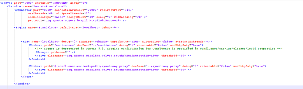

I believe the config is done correctly, please see the screenshot for reference. iisaYLbCMp.png
Work fine when trying to access it http://SERVER_NAME:8090 but not when using the base url

Fabio Racobaldo _Catworkx_
September 22, 2023
Based on the configuration file you should access tool with  http://SERVER_NAME:8090/confluence (that should be the base url). Isn't it?

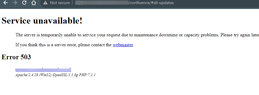

This is the message we get when we open confluence using http://SERVER_NAME:8090/confluence image2017-3-23+14_39_14.png
