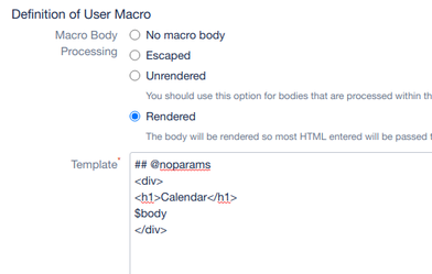

I am creating a DIV macro that will allow users to place custom <div> tags and place content within the div.
I tested with an iframe and i noticed that there are extraneous tags being displayed as plain text after the iframe.
I'm just basing this test on the "collapse" macro from this page: https://confluence.atlassian.com/conf73/writing-user-macros-991928530.html

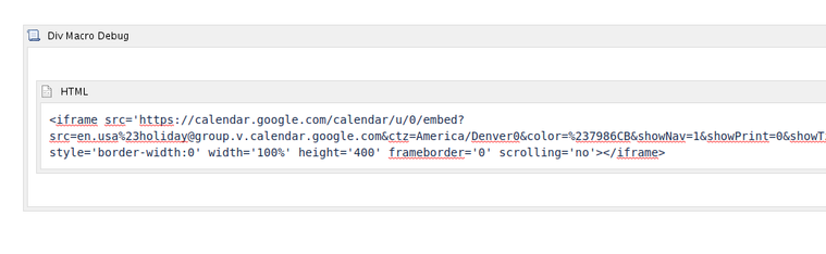

I'm putting the HTML macro with my iframe within my DIV macro.

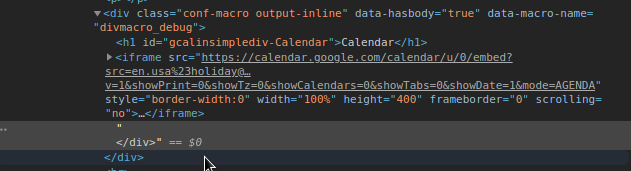

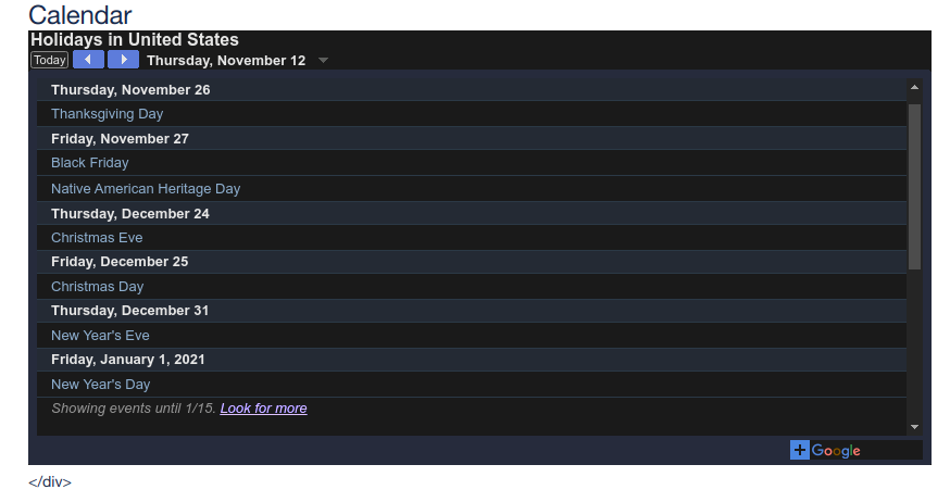

screenshot_2020-11-12_08.32.09_img.pngThis is what the rendered page looks like.  The iframe is correctly inside my div container, but there is an extra "</div>" printed after the iframe
Looking at the page source, the </div> is both in the html as expected but also in some text after the iframe.

Putting the iframe directly in the macro (not using the nested html macro):
<div><iframe>...</iframe></div>  still has the issue
Putting just the iframe in the macro seems to work fine.
